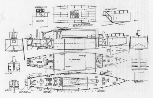

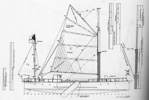

My boat design hero Phil Bolger drew up a small steel motorsailing cargo ship in response to the specific needs of some Pacific island nations that are dependent on small cargo ships for most of their trade and transportation. The cargo ships are usually old and run down, so cheap to buy but expensive to operate.
"Sir Joseph Banks" was intended to operate on both motor and sail simultaneously for economy and flexibility. A junk-like rig reduced crew needs and a flat-bottom sharpie hull allowed direct beaching for loading and unloading while heeling when under sail reduced pounding. An alternative passenger layout of four-high pipe berths provided spartan accommodations for 80 passengers, such as when taking school kids to boarding school on the mainland. The whole thing was designed to be cut from patterns on sheet steel and welded together right on the beach.
It was never built, but it would have been glorious. I have alway thought that if I won the lottery I'd have one built as my home, reducing the cargo hold for more and better accommodations but keeping a small hold to carry my toys with me wherever I go.
Source: Boats with an Open Mind: Seventy-Five Unconventional Designs and Concepts, Philip Bolger, McGraw Hill Professional, 1994
Cheers,
Matthew
