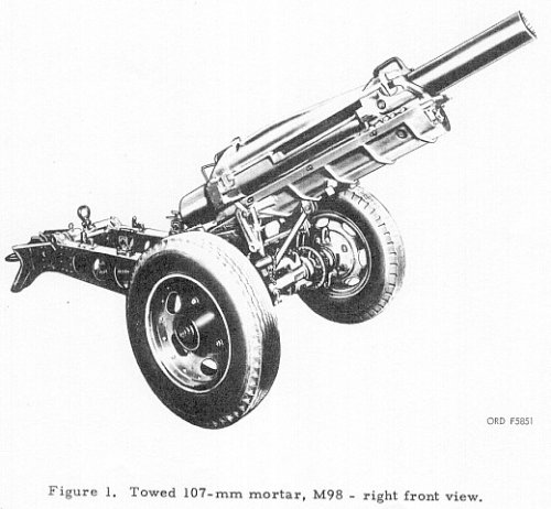

The US Marines once fielded an interesting weapon called the M98 Howtar, which was simply a 107mm (4.2-inch) mortar mounted on the carriage of the 75mm pack howitzer. Again, it was basically an indirect weapon, but being carriage-mounted made it much faster in and out of action.
The M98 Howtar come closest to what I was looking for, thanks.
But of course the Howtar was not a direct fire weapon as far as low angle firing ( i.e you can't shoot at a window).
