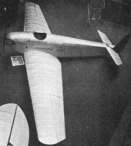

The illustrated types were the Tri Druga and Burewestnik, two monoplanes with air-cooled flat-twin engines. Both designs were from Ossoaviachim, the paramilitary 'Society for Air and Chemical Defence'.*

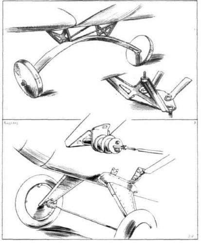

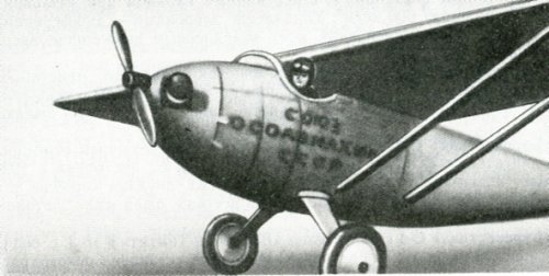

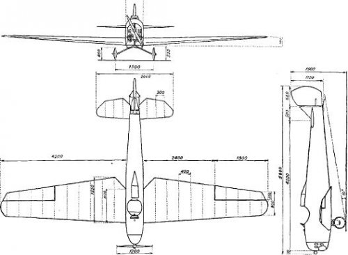

Tri Druga ('Three Friends') - two-seat light sports monoplane (high, strut-braced parasol). Flight comments on the novel undercarriage arrangement. Shock absorbing is by rubber block - as the u/c legs spread under load, a wire 'axle' compresses the rubber.
Length 6.92 m (22.7 ft); span 12 m (39.4 ft); tare weight 245 kg (539 lb); gross weight 417 kg (906 lb); maximum speed 127 km/h (79 mph); and ceiling 5,250 m (17,500 ft).

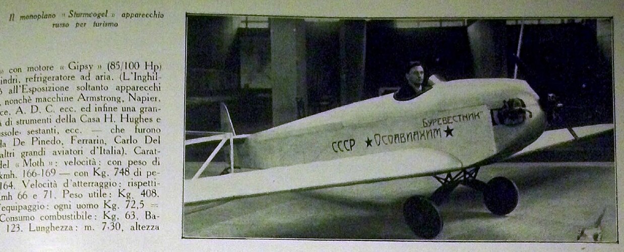

Burewestnik ('Stormy Petrel') - single-seat light sports monoplane (low-wing). All-wood construction with fabric-covered wings. Undercarriage consist of a curved wooden axle carrying wooden wheels shod with leather tires.
Length 6m (19.7 ft); span 9 m (29.5 ft); tare weight 150 kg (330 lb); loaded weight 270 kg (594 lb); maximum speed 155 km/h (96 mph); and ceiling 7,000 m (23,000 ft).

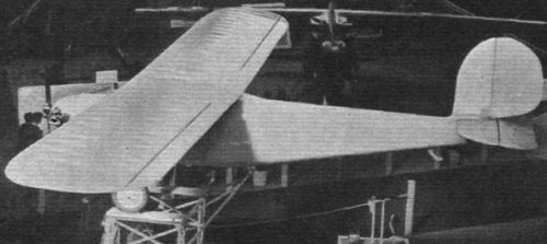

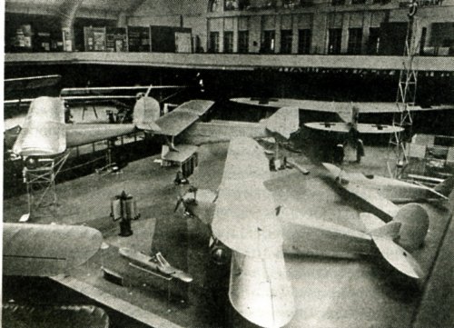

Berlin, autumn 1928.
At the forefront of the U-2 (the second test version), then anti-clockwise:
"Burevestnik S-5 (the same S-4, but with an engine" Bristol Cherub "30 hp).;
Kalinin K-4 (ambulance with red cross);
ANT-3 / R-3 recon Tupolev’s;
"Three friends" S.Gorelov / A.Semenov / L.Sutugin

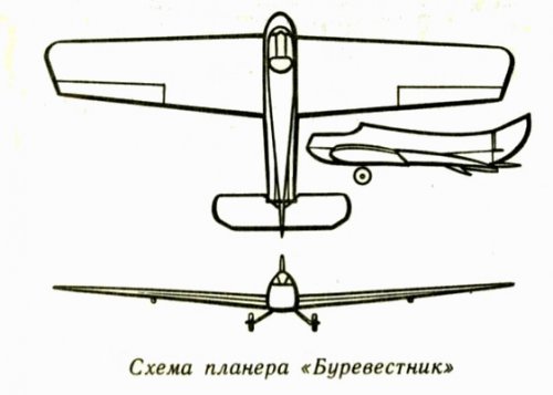

A few words about the «Burevestnik» ...

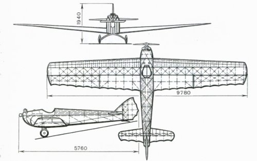

Vyacheslav Nevdachin - an engineer and military pilot, built between 1922 and 1929: glider and four aviette under the title "Burevestnik".
1) sailplane "Burevestnik P-5 (L-4,9m; S-10,5m; Ar.W.-15m )
2) "Burevestnik” S-2 (engine Harley -9 h.p. L-6,0m; S-10m, Ar.w.-15m)
3) "Burevestnik” S-3 (engine Harley -12h.p. L-5,8m; S-9,8m; Ar.w.-12,5m)
4) "Burevestnik” S-4 (engine Blackburn-Tomtit -18h.p. L-5,8m, S-9,0m; Ar.w.-9,6m )
5) "Burevestnik” S-5 (engine Bristol Cherub -30h.p. L-5,8m, S-9,0m; Ar.w.-9,6m )

If you think that "three friends " is Gorelov, Semenov and Sutugin then you know only half of ...
The name comes from the slogan with which the aircraft project was filed for the contest AVIAHIMa back in 1923, namely: «Strength, simplicity and cheaply - the three best friend's aircraft fleet»
In addition to this aviette was one more (at least) the product of collective efforts of the same name, is: "The three friends” A. Putilov, V. Alexandrov and brothers Pogosskih, but less successful.
