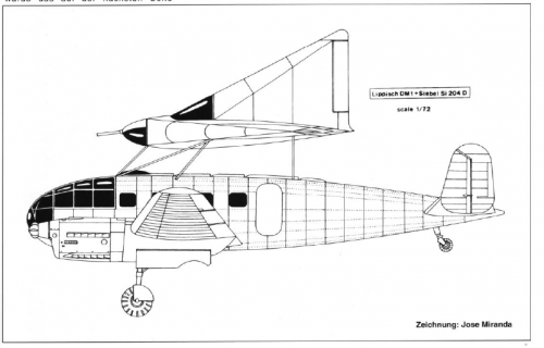

Hi, all,
I'm new in this excellent forum. I would like to know if someone can help me with my doubt. I'm going to build the DM-1/Siebel Mistel composite in 1/48 scale. But I'm a bit confused, since in one book ( Lippisch P-13a, by Hans-Peter Dabrowski, published by Waffen-Arsenal series) the mother aircraft should be a Siebel Si 204 A version, which carries atop the Lippisch DM-1 wooden glider. But I have another book, "Secret Wonder Weapons of the Third Reich", German Missiles 1939-1945, by Justo Miranda and P. Mercado, published by Schiffer. In this excellent book, on page 28, there is a drawing about a Mistel composite with a Siebel Si 204 D version, and the DM-1 mounted atop.
So, does anyone know which one Siebel version is the correct? Which one should carry the glider?

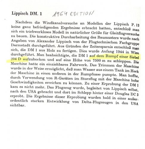

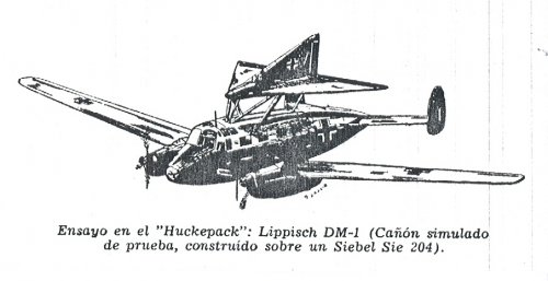

The subject of your interest is of a highly speculative nature as it intends to clarify to which airplane version belongs the possible bearer of another that was not yet built in Germany by the end of the war.
When I made the drawing you describe I used the information (text only) from the book 'Die Deutschen Flugzeuge 1933-1945 Nachtr." by Karlheinz Kens and Heinz J. Nowarra, J.F. Lehmann 1964. As you may appreciate in the attached text it mentions the Si 204 D. However, a later edition of 1969 just mentions the Si 204.

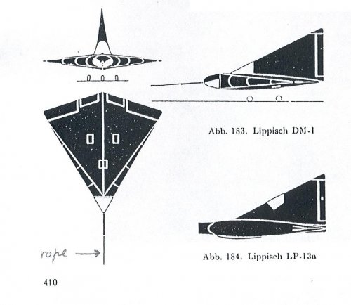

As for other sources, Lippisch himself in his book 'Ein Dreieck Fliegt' (Motorbuch Verlag 1976) does not make any reference to it and the pictures of the time show the DM-1 with a tube in the nose to connect a towing conventional system. The rope can be seen in the attached drawing.
The bibliography is vey confusing. Wieslaw Baczkowski published an illustration of the si 204 D in Wydawnictwo Bellona No. 166 (1997).
- David Masters (Jane's 1983) and Robert Forsyth (Classic Publications 2001) talk about a Siebel Si 204 without referring to any specific version
- Hans Peter Dabrowski (Poznum Pallas 1986), Manfred Griehl (Monogram 1998) and Joachim Dressel (Motorbuch 1989) mention the Si 204 A version.

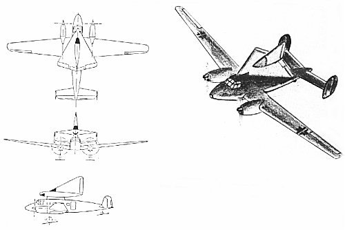

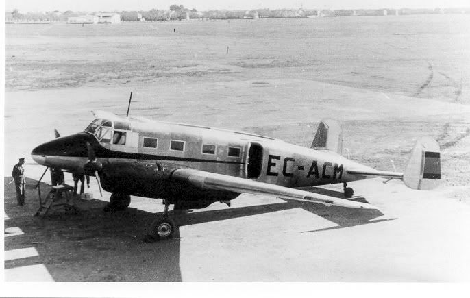

I will also add an illustration on the Si 204 A.
Regarding my drawing, the only extrapolation I made was the shape of the struts connecting both airplanes. To that purpose I used the information included in the pictures of the windtunnel testing and on the system used with the Me 328/Do 217 K V3 combo.

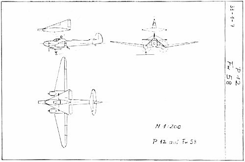

Thanks,Justo, here is a mistel plan

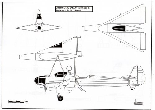

From my dear Justo and Flugzeug Profile No.20.
Eyeball engineering the FW 58C says that it is poorly balancd with the Lippish Delta too far forward.
All the other Mistels look properly balanced.
