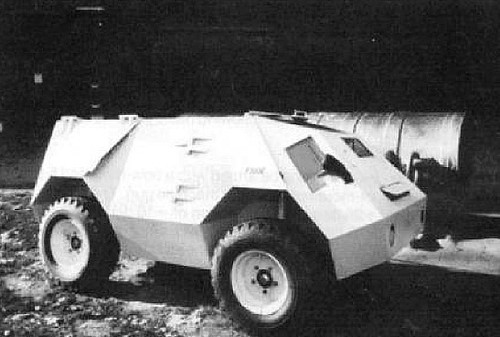

F333E "Lizard"
The Ferrari F333E Lizard was an odd little vehicle, it offered sports car performance with armored protection and special operations capabilities; had a reasonable price (one could buy several "Lizards" for the price of one Ferrari's top-end sports car) and provided a status symbol for some third-world dictators. Unfortunately it did not make any waves with the military, because of Ferrari's "absolute lack of experience in the military sales market"

Here is some more data on the Lizard. The following information has been copied from Jane’s Light Tanks and Armoured Cars 1984 by Christopher F. Foss. It is posted here for educational purposes.
Lizard F333E Light Armoured Vehicle
Development
The Lizard F333E light armoured vehicle has been developed as a private venture by Ferrari Engineering SRL. The first of three prototypes was completed in 1980 and early in 1983 a batch of 15 pre-production vehicles was being built.
Description
The hull of the Lizard is of all-welded steel that provides the crew with protection from small arms fire and shell splinters. The floor is of double-skinned construction for increased protection against mines. Provision is made to prevent magnetic mines being attached to the hull. Its small size and low profile also increase its survivability.
The driver is seated at the front of the hull with bullet-proof windows to his front and sides. A 5.56 mm machine gun can be mounted to the right of the driver firing to the front of the vehicle. The commander and gunner are seated in the centre of the vehicle with a forward opening door being provided in each side of the hull. In the forward part of the roof is a single-piece circular hatch that opens forward where the light armament, for example, the 5.56 mm or 7.62 mm machine gun, is mounted. In the roof to the rear of the circular hatch is a two-part roof hatch that opens either side; a retractable missile launcher system can be installed at this position.
The engine compartment is in the lower part of the hull rear with the radiator at the very rear. The Lizard has permanent 4 X 4 drive and front, central and rear self locking differentials are fitted as standard.

SPECIFICATIONS
CREW 2 or 3
CONFIGURATION 4 x 4
COMBAT WEIGHT 2600 kg
UNLOADED WEIGHT 2100 kg
POWER-TO-WEIGHT RATIO 44.23 hp/tonne
GROUND PRESSURE 1 kg/cm2
TOWED LOAD 1000 kg
LENGTH 3.3 m
WIDTH 1.7 m
HEIGHT (hull top) 1.42 m
GROUND CLEARANCE 0.3 m
TRACK (front) 1.385 m (rear) 1.424 m
WHEELBASE 1.8 m
ANGLE OF APPROACH/DEPARTURE 45°/47°
MAX ROAD SPEED 120 km/h
FUEL CAPACITY 2 × 50 litres
RANGE AT 60 km/h 800 km
FORDING 0.6 m
GRADIENT 60%
ENGINE FIAT 4-cylinder petrol developing 115 hp at 5600 rpm
TRANSMISSION manual, 5 forward and 1 reverse gears
TRANSFER CASE 1, 5, 3, reduction
STEERING power assisted, rack and pinion
SUSPENSION independent, telescopic struts with double acting hydraulic shock absorbers (twin on rear wheels), four longitudinal torsion bars
TYRES 11.00 x 15 bullet-proof
BRAKES power-assisted, dual-circuit, mechanical parking brake operates on rear wheels
ELECTRICAL SYSTEM 12 V
BATTERY 1 × 12 V, 63 An
Status: Prototypes.
