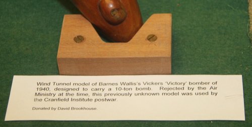

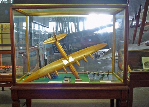

Haven't seen anyone point this out - but a rather nice wind tunnel model of the Vickers 'Victory Bomber'
seems to have turned up at Brooklands
Can see it on the web at
http://en.wikipedia.org/wiki/File:BrooklandsVictoryBomber.jpg
It seems to have been there a while so this may be old news.

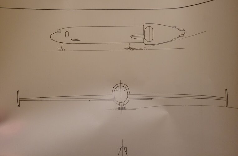

Can anyone have the 3 views or sketch of the Victory bomber?I just know that It was made by the British designer Barnes Wallis used to drop the earth quake bomb on Germany but it wasn't go further than windtunnel model.

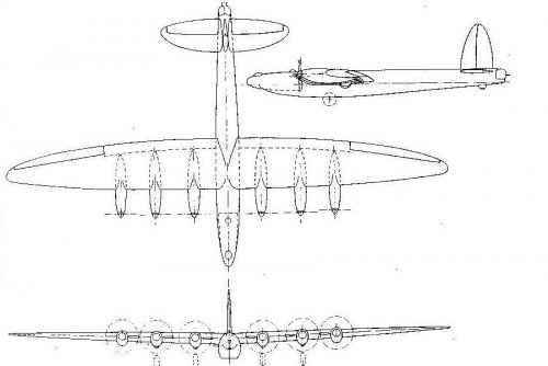

Hi VC!!!
Will this 3-view be all right?
Chuck
SOURCE:
Vickers Aircraft Since 1908
By: C.F. Andrews and E.B. Morgan
pg. 562

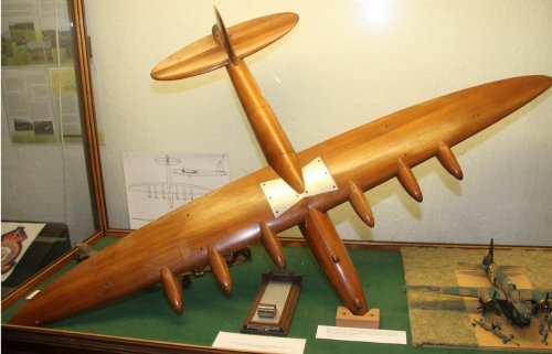

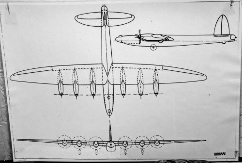

Had to go to the UK on a (automotive) research project and looked in at Brooklands. Here are updated pix of the display, new info, and the 3-View they have added.
