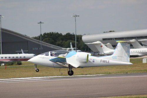

The Airbus E-Fan (Electric Aircraft) two-seat concept aircraft has been on flying at Farnborough FIA 2014 this week.
It is an all-composite construction, 6.7 m (22 ft) long and a wingspan of 9.5 m (31 ft).
It has two ducted, variable pitch fans spun by two electric motors with a combined power of 60 kW.
The centrally mounted fans provide better control. Powering the fans are a series of 250 Volt lithium-ion polymer batteries made by KOKAM of the Republic of Korea.
The batteries are located in the inboard section of the wings and carry enough charge for up to one hour of flight and can be recharged in one hour.
The undercarriage main and nose-wheel are centrally located and light outriggers are used to save weight.
