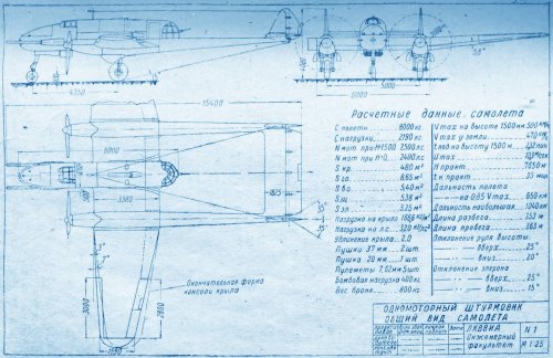

From The Osprey Encycolpedia of Russian Aircraft : "Col Bedunkovich never had his own OKB, but recently (maybe 1995, I suppose) a 3-view has been found of a 47 project for a heavily armed Shturmovik, noted for its twin-boom layout making possible a rear turret. Guns: 2x37mm, 1x20mm, 5x7,62mm. Not explained is the title: Odnomotornyi (single-engined)".
3 view shows a twin-boomed aircraft, with two propellers in the nose of each tail-boom, heavy armament in the nose of nacelle and a turret in the rear. The engine was buried in the middle fuselage with a big air intake under the belly and smaller on top, propellers driven via shafts ang gears; hence the explanation of "single-engined".
Incorrect date 1947, maybe 1939-40.
Anyone knows more?

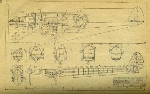

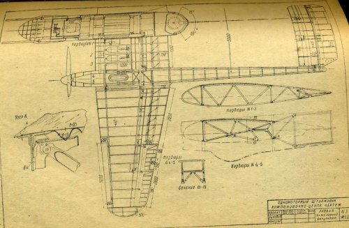

I'm enclosing the blueprint for the Bedunkovich attack project.

Hi Visvirtusvoluntas,
I think the answer comes as following; if we imagine there was a single engined
driven two propellers,just my theory.
And for Stargazer,yes he worked for NIAI.
Thank you my dear Borovik,
and as I expected.
NIAI project - 1946 years (responsible for project engineer A. Bessonov / taken as a basis of his the degree project)
Dobrynin engine M-250 (liquid cooled)

Now I more puzzled than before. That is the only detailed plans of one aircraft in the book. Why? Is that project an example for the book ?
