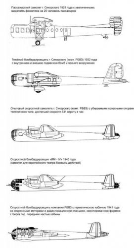

I can't ID those projects,who can help ?.

Fake 100%
Of a text written in broken Russian (about how I write in English)) that this is the period 1928-1941 Sikorsky Aircraft's ...
Probably strongly influenced by Ernst Heinkel AG ;D
I'd say fakes. The second drawing has a tail lifted from an He 177 while the third, fourth and fifth have Do17/215 tails. The third and fourth have wings/engines pinched from a pre WW2 French medium bomber project. Alt history?
... and N° 3 and 4 wings were taken directly from the Breguet Br.482.
Would be good to know the source, as either it's an alt.history site,
or just a "fake slinger" !
OK my dears,
here is the source,and I agree ,it is fake;
http://alternathistory.org.ua/vopros-k-kollegam?page=2
Yep, completely fake. And just take a look further down at these "Russian" "Seversky Kartvelishvili SK-47 Drosd" (Thrush) of 1936 if you still need confirmation... or the "Sikorsky S-44" of 1938 just below it!
