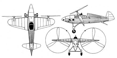

Engineer Nikolai Zhuchenko (americanized spelling) built in 1938 what may have been Europe's very first tilt-rotor prototype, the Vertoplan. A true VTOL before the term was even coined, the Vertoplan was meant to take off and land vertically. I have not been successful in digging more information about Zhuchenko (was he Russian? Yugoslav?) and whether his aircraft actually flew or not. Help, anyone?

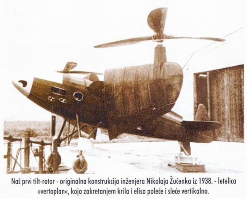

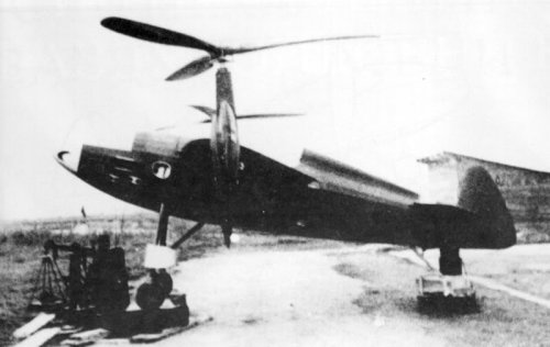

He was a Russian who emigrated after Bolshevik revolution to Yugoslavia. In 1937 he proposed Vertoplan to the Yugoslavian army. All-wooden prototype with canvas covered fuselage was built. It did not have cyclic control, so the pilot was not able to control the plane in all three axis. It was not a big problem, because the plane never flew (despite other reasons it had very weak Walter Mikron engine).

The text says: Our first tilt-rotor, original construction of engineer Nikolai Zhuchenko from 1938.- Vertoplan flying craft, which uses wing and propeller rotation to take off and land vertically.

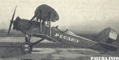

As for Zucenko, he also worked in Novi Sad arsenal where he built another craft, classified as sport/tourist craft Resava (it's a name of the county,river and monastery in Serbia).

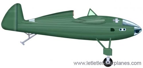

I dug up some more, the name given to the vertoplan by it's author was aerostatoplan, and there was even a model kit of it.Perhaps the moderator should rename the thread.
link to the english text about this vtol attempt
http://yumodelclub.tripod.com/history_of_yugoslav_aviation/zucenko.htm

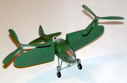

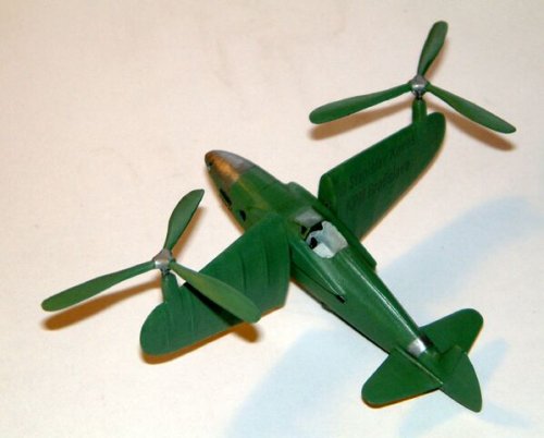

Photos of the 1:72 model, from Bratislava.
http://www.kpmbratislava.sk/main/galery/keves/g1/indexeng.htm
Hi biglava, do you have more informations about the "Resava"...

I bought a Kora 1/48 resin Zhukoxskii Aerostatoplan, an early experimental tilt rotor VTOL, which had a centrally located Walter Mikron engine of some 50 hp. While there are some photos available, such as closeups of the 4 exhaust stack stubs that protrude a bit(which are not shown in the kit, although there are a pair of pe piece for exhaust holes in the right places), which are helpful, I have to find any photos of cockpit or engine installation.
And more importantly, I can't find any more information on this beyond a Russian aircraft site.
While a 50 horse tilt twin rotor VTOL might sound ridiculous(lack of power, perhaps?), Who was Zhukovskii, beyond a Russian engineer in Yugoslavia,but what ultimately became of the design and the designer?
