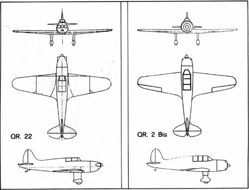

Other QR designations are for prototypes -- the single-engined (Fiat radial) tourer QR.2bis (I-BICI) and another single-engined light monoplanes, the QR.22 (no details). I saw these listed as Marinavia Farina built aircraft. Can anyone confirm?

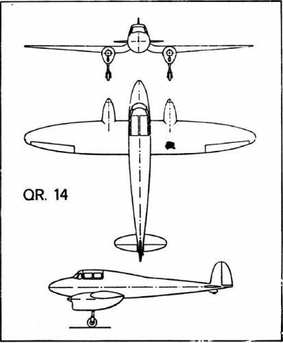

from Aerofan magazine,the QR.2 and QR.22 drawings and QR.14 3-view.

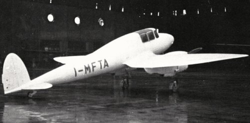

Further informations about Levriero from the GAVS (Gruppo Amici Velivoli Storici - Historical Airplanes' Friends Group):
Marinavia Farina QR.14 Levriero (I-MFTA)
Built in 1942
First Flight 03/10/1947 at Vergiate
Jane's All World's Aircaft p. 170

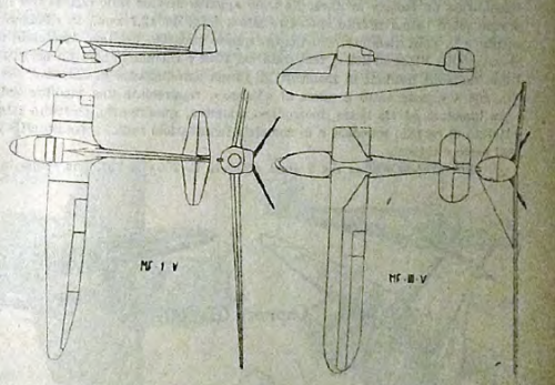

Was this article related to this subject ?,and they mention M.F.1 V,M.F.3 V & M.F.4 V.
http://www.avia-it.com/act/biblioteca/periodici/PDF%20Riviste/Ala/L'Ala%201947%20011.pdf
Those were a gliders.

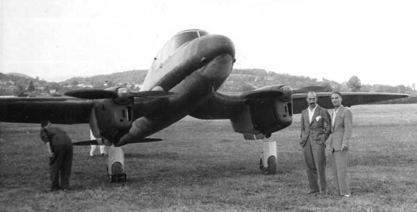

Found few more pictures here http://www.aviastore.it/?p=8831
(foto archivio F.Anselmino)
  • 103_Marinavia_QR.14_I-MFTA_Linate-probabilmente_1948_archivio_F.Anselmino-copia.jpg

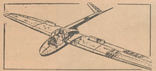

From Ailes 8/1947,
the Marinavia M.F.3 V glider.

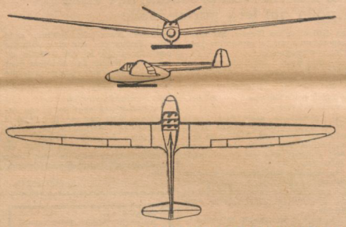

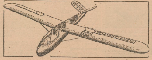

Here is a Marinavia M.F.1 V glider.
