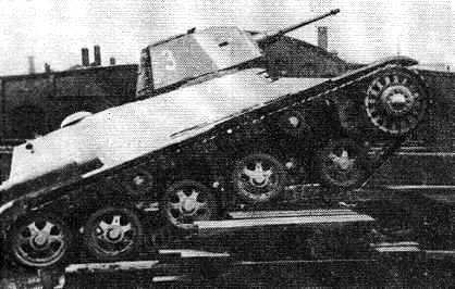

I wish to know more about this elusive Swedish tank. The few articles I could find about it is regarded to the L-100 tank with 20mm AT gun. Do you guys know more about this vehicle? A drawing or photo maybe? Does even the Swedish built the L-101?
Not a single one of this forum have any info about this vehicle???

In 1933-4 the tank department of the company (Landsverk) had also turned their attention to ultra-light tanks of less than five tons in weight. They designed two such machines, the L-100 and the L-101. The L-100 prototype, developed in 1934, was a small 4.5ton tank armed with a single machine-gun and with a striking speed of 55kph. It seems that the L-101 design (which actually preceded the tank possessing the earlier designation) was dropped soon after the first drawing-board studies.
That seems to mean that no prototype was ever built and that were only some drawings, but as the only known photograph of the L-100 depicts a prototype armed with a 20-mm gun instead of the machine-gun, we could speculate that the light tank was completed (or modified later) as L-101, but it is only a possibility.
I think it is better to have the opinion of some experts on Swedish armour
Nico
To add to that, one source describes the L-101 as a proposal for a 'ultra-light tank destroyer', apparently intended as a way of getting around some rather ridiculous Swedish traffic laws which were then restricting the movement of armoured vehicles on public highways.
It's likely, but not confirmed, that the original L-101 concept was a turretless design with heavier armor (15mm at it's thickest?) than the L-100 (9mm at it's thickest), with a fixed Madsen 20mm A/T gun (confirmed) as it's intended primary armament. For some reason, the design team didn't consider the Bofors 37mm anti-tank gun, although this may have been because a (domestically produced) tank mounted version wasn't readily available at the time the concept was drawn up.
