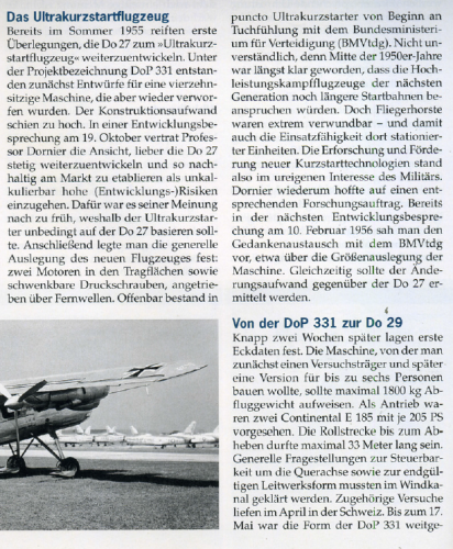

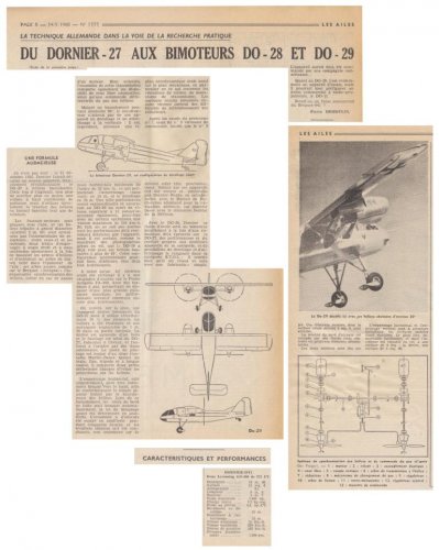

Dear Boys and Girls, here is part of an article in French about the Dornier Do-29 V1 STOL light aircraft prototype which was apparently based on the nazi Focke-Achgelis FA 269 "project" of 1941. The rest of the article (edited-out) is about the Dornier Do-27 & Do-28 light aircraft......
The article comes from the 14th May 1960 issue of Les Ailes......
Terry (Caravellarella)
  • Dornier Do-29 V1 STOL light aircraft prototype - Les Ailes - No. 1,777 - 14 Mai 1960 1.......jpg
  • Dornier Do-29 V1 STOL light aircraft prototype - Les Ailes - No. 1,777 - 14 Mai 1960 2.......jpg

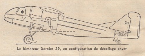

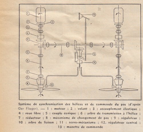

Dear Retrofit, it isn't a matter of increasing the resolution. Les Ailes was a weekly newspaper with a low print and paper quality. Each page is larger than A3, 43cm by 30cm; so the issue is trying to fit the articles into a document that will meet this website's requirements on size. The original resolution of Les Ailes is quite poor and please remember that I am constrained by dealing with oxidised and perished newsprint that is 50 - 70 years old......
  • Dornier Do-29 V1 STOL light aircraft prototype side-elevation drawing - Les Ailes - No.jpg
  • Dornier Do-29 V1 STOL light aircraft prototype transmission drawing - Les Ailes - No.jpg

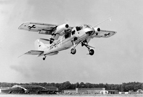

Hi folks,
in the December 2011 issue of the French Magazine "Le fana de l'aviation" there is a very interesting article about the STOL aircraft Do 29. The article also has a company artist concept picture showing the Do 28C, a proposed (eight-seat?[1]) version with two Turbomeca Astazou II turboprops. Dornier used the fuselage of the Do 29 V2 for the Do-28C mockup.
[1] Source: Wikipedia Dornier Do 29

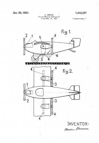

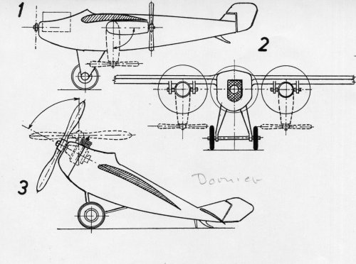

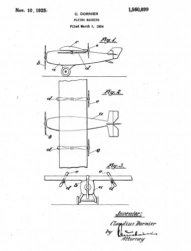

By the way, the DO-29 was NOT based on the FA-269. Claudius Dornier had the idea of tilt-engines/props as early as 1921. (see patent drawings)

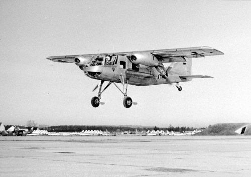

Well, my English is far from being perfect, but I will try to translate what I´ve got about the Do 29.
All in all, the plane was a disappoinment. A report from December 1959 states the following
Max. Speed: 230 km/h (planned were 330 km/h)
Landing speed: 70 km/h (planned 25 km/h)
Take off after 80 m (25 m were planned), 45 m for landing (again, 25 m were planned) .
After prototype V2 had an accident on 5th July 1962, the aicraft was written off.
Even though testing continued with prototype V1 until summer 1963, no further development took place.
Landing speed certainly seems high for a STOL vehicle. No wonder you're mentioning disappointment! I have very fractioned and unverified pieces of information from a couple of websites that mention the Do.29 once flew as slow as 24 km/h. That's more in line with STOL performance, but I don't know how accurate the claim was :(
AFAIK, the Do 29 wasn't actually tested to its limits, because up to the end of this program,
there were problems with the propeller control. At first Hartzell props were used, later those
from Ratier, but problems remained at high prop angles.
Interesting. Reminds me of the troubles the Ryan VZ-3 run into. It couldn't really hover in ground effect, so it was a failure as a VTOL. However it had very useful STOL performance. I would be curious to know what kind of performance goals the designers had set with the props at 90 degrees, and what they were able to achieve with the props at 60.

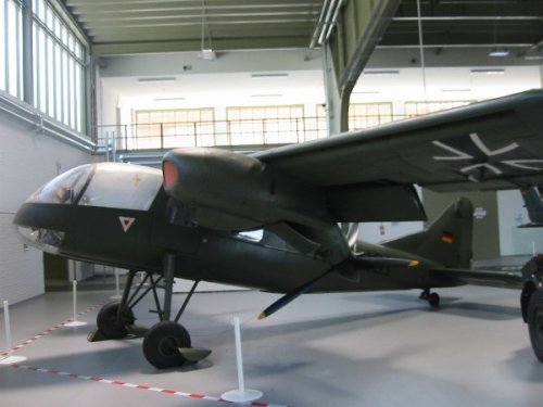

Eureka ! It was there, it still is there and I've actually seen it some years ago! Wasn't sure anymore,
as I couldn't find a clue, not even on the website of the "Luftwaffenmuseum Gatow" (airforce museum Gatow).
But someone else took a photo several years ago and now the Do 29 is stowed in a hangar there, that usually
isn't open to te public. Maybe I can make a visit in September, as then those "secret" exhibits are shown, too.
(Photo was made by a member of the German Flugzeugforum ("Cirrus") and posted here:
http://www.flugzeugforum.de/forum/showthread.php?35030-Hangar-7-und-Hangar-8-in-Gatow)

I have seen it at Gatow too , but , I believe it is now at Dornier Museum Friedrichshafen... Or perhaps back to Berlin ?

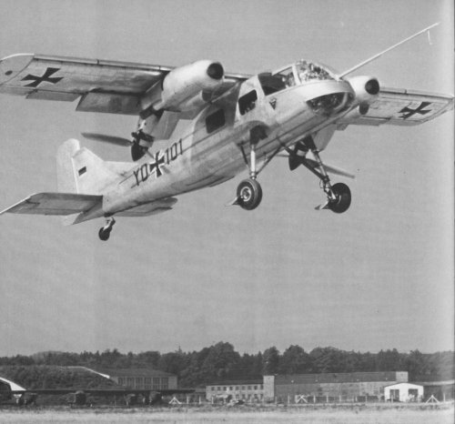

Dornier Do 29, not D29.
http://www.secretprojects.co.uk/forum/index.php/topic,12828.msg138766.html#msg138766
gery said:
Dornier D29 vtol concept of 1958
Much more than just a "concept", actually a flying prototype.
There is already a topic here with several photos and even scan of French-language articles:
http://www.secretprojects.co.uk/forum/index.php/topic,12828.0/all.html

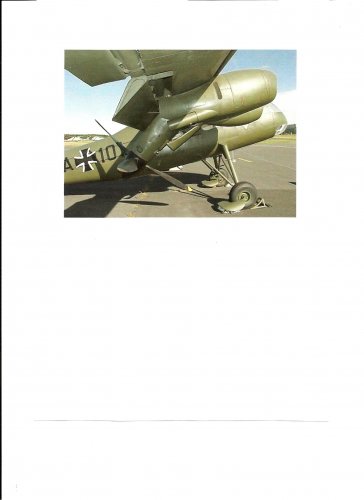

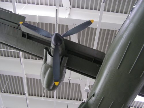

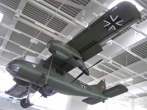

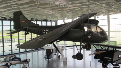

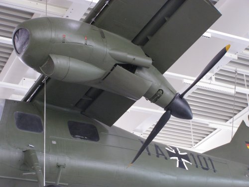

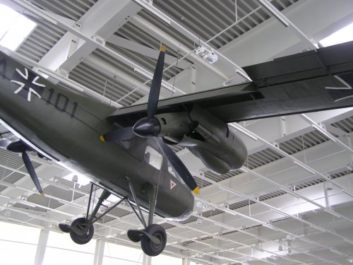

I had taken these photos in the Dornier Museum in Friedrichshafen in 2010 - hope they are of use here:

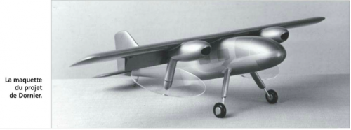

The Model for Dornier Do.29 or P.331.
Le Fana 505
