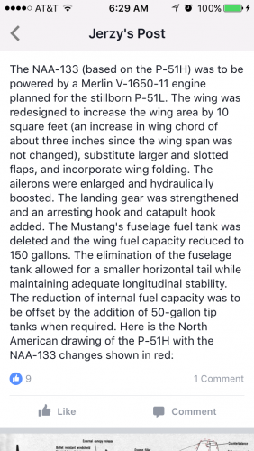

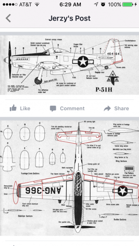

Found this on Facebook this morning.
Model of P-51H:
