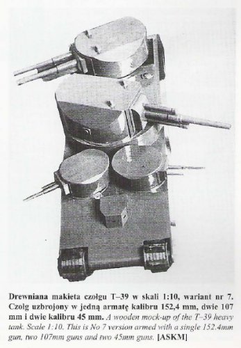

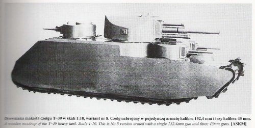

For whatever reason, I love the T-35 tank. So, found a copy of the Polish book "T-35/SMK/T-100", Wydawnictwo Militaria #159 which covers the T-35 development in-depth. Sadly, I don't read Polish but the photographs are captioned in English. In the book, the T-39 was shown, a tank project I'd never heard of. Check them out. Talk about a serious monster of a tank....
This book is actually a translation from the Russian Frontline Illustration series.
The T-39 was a heavy tank project designed to the late 1920's standards for a heavy tank intended for breaking through permanent fortification lines. Such a vehicle was to be armed with a 107 mm gun or a 152 mm howitzer, was to be capable of firing at at least two targets at one time and have an armour protecting from divisional guns. Six variants were designed in 1933, and - after comparison with Grote and Ansaldo projects - three more were created and built as 1:10 scale mock-ups (known from the photographs). It's hard to say which version is which, as they are mixed again and again by different authors, but it seems the version no. 8 was chosen for further development - it was to be armed with one 152 mm howitzer and three 45 mm guns in four separate turrets. The tank was to be some 90 t heavy, have 70-75 mm armour and reach 24-33 km/h with a 970-1300 hp engine (a steam engine was even concerned).
What's interesting, the T-35 heavy tank (favoured by Voroshilov) wasn't actually a heavy tank as far as its armament was concerned, but - along with the high cost of the prototype - it was probably one of the reasons of cancellation of the T-39 project in early 1934.

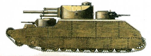

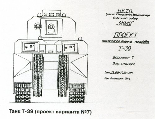

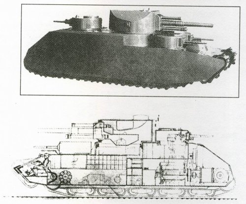

...small visual addition to the information Grzesio
from: "Domestic armored vehicles. XX Century" vol -1
A. Solyankin, I. Zheltov, M. and I. Pavlov's
"The Soviet heavy tanks 1917-1941" Eksprint

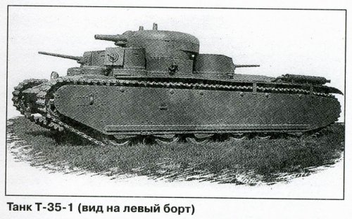

Did they actually start work on the T-39 prototype? Was there any hardware completed or nearly so?
I don't think anything was done.
The cost of the prototype (estimated as 3 million Roubles) together with Voroshilov's opposition caused the project to be abandoned at an early, conceptual stage.

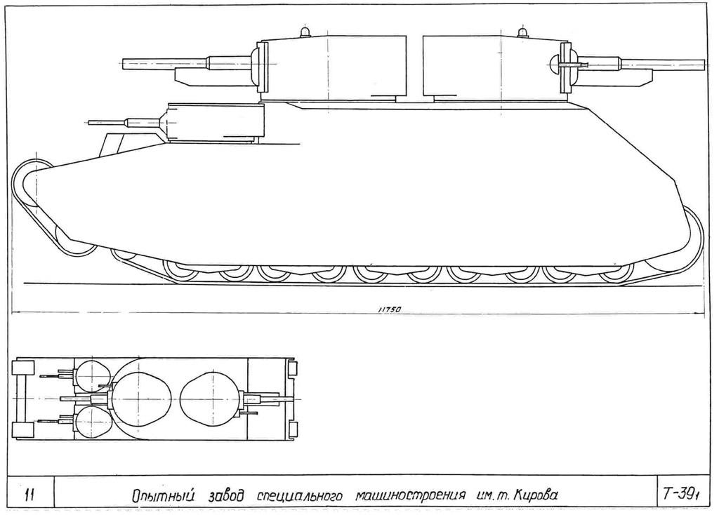

Hello!
Does anybody has good drawings of the T-39 tank? For scaled model referente. Thanks!
From Yuri Pasholok livejournal
