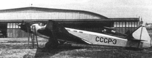

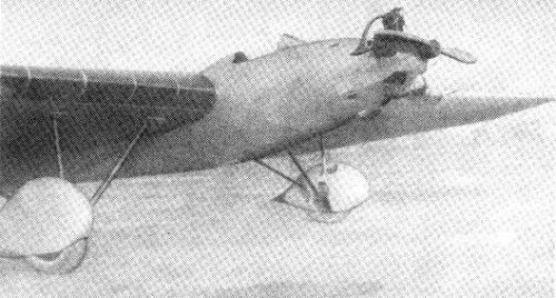

Rather your second guess is right. RMK-1 was so-called Planerlet (Планерлет), which can be translated as “gliderplane”. This concept and the term itself are inventions of Lev P. Malinovsky, the Osoaviakhim vice-president and Civil Airfleet (GVF) chief of Scientific & Technical Department. He published his ideas in Samolet magazine, No.12/1933, under title “New Ways of Gliding” (Новые пути планеризма). His main idea was that permanent increase of flight speeds conflicts with economical reasons; it isn’t always necessary (sometimes even harmful, as in agricultural aviation) but very expensive (as it requires more and more powerful engines which burn plenty of fuel). Therefore he proposed a new, optimized kind of flying machine combining the best features of a conventional airplane and a glider. As “normal” aircraft, the Planerlet could maneuver independently of thermals; but it would have such “glider” features as: high L/D ratio, low landing speed, limited wing load. Empty Planerlet could takeoff by its own power, but with full payload it could need an assist of towing aircraft.
Malinovsky considered that his “gliderplane” would be much more costeffective in service than classic transport airplane, and their wide introduction would yield large economic benefits. But not all the specialists agreed with him. In 1934-35 there was a discussion about this in “Samolet” magazine: both supporters and opponents of planerlet put their arguments. Among the supporters there were Eng. Viktor Belyaev (later renowned designer of many unconventional aircraft, the best-known of which is DB-LK bomber), Pavel Ivensen, and Sergei Korolev (future “father” of Soviet space program); the main opponents were Eng. Ramm and V. Markin, deputy editor of "Samolet" magazine. As a result, it was decided not to introduce Planerlets widely for a while, but to build some experimental types and test them.
Three types of Planerlets were built and flown; probably the best known of them is Kharkov-built KhAI-Aviavnito-3 Sergei Kirov flying wing, designed by A. Lazarev and A. Krol. It was first flown at September 23, 1936 (pilot E. Schwarz), and was actually used in 1937-38 on Moscow Oblast regional airlines for cargo and passenger transport (it was the world’s first flying wing really used as transport aircraft!). Two other prototypes even obtained “LEM” designations – for Lev Malinovsky. The LEM-2 (OKA-33) was designed by Oleg Antonov, and became the first powered aircraft by him; its first flight was at April 20, 1937 (pilot N. Fedoseev). Another was Leningrad-built LEM-3 (LIG-6) designed by Yu. Domrachev and L. Vildgrube; it was also tested in 1937 but crashed during overfly to Moscow. Also there was one military Planerlet – it was powered version of Grokhovsky G-31 assault glider called G-31A and tested in 1935. Like its motorless prototype, G-31A could carry 16 troops in special sections inside thick wing. All Planerlets were powered by 100-hp M-11 engine.

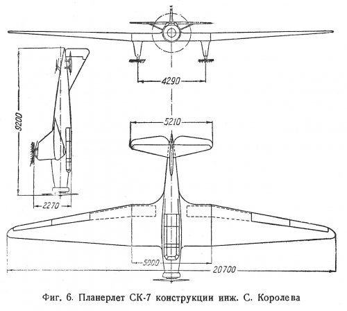

The construction of two other Planerlet types was beginned but never finished. One of them was 6-seat SK-7 designed by Sergei Korolev (with assistance of Petr Flerov). And the second was subject of this topic – the RMK-1. Romeiko-Gurko designed it together with Dmitry Kolesnikov, renowned glider designer (his DK-2 established new Soviet Union record of flight range for gliders at September 20, 1934). So, “R” and “K” letters in the designation are for two designers; “M” is perhaps in honor of Malinovsky?
Unfortunately I don't have RMK-1 pictures now. I attach some pictures of other Planerlets.

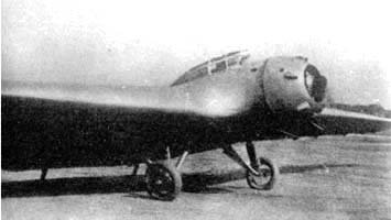

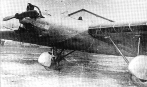

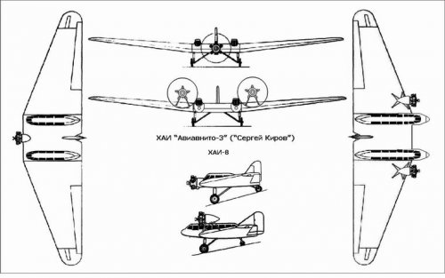

Hi redstar72,
from your last source: ХАИ-8 — это тот же планерлет ХАИ-3, но с двумя двигателями М-11, установленными на стойках над крылом, с тянущими винтами. Строился в 1936—1937 гг., но не был закончен..
Do you have a drawing and technical data for this bird?
Thanks Maveric
Maveric
Unfortunately not. I also want to find a picture of KhAI-8...

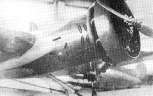

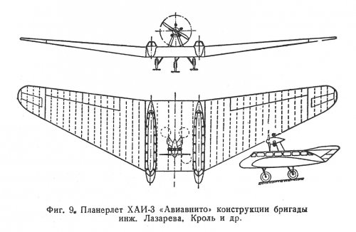

Here is a very intriguing picture of G-31A with M-25. According to "Last Hope" article (M.Orlov. The Last Hope. Wings of Motherland, #3 2002, p.10) this variant wasn't built. Is this a real photo or just an artist impression?

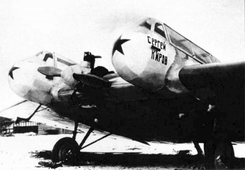

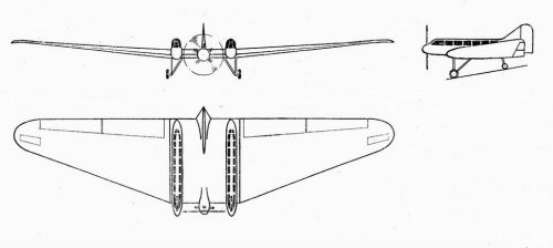

BTW, the scheme and photo of HAI-3 don't correspond. On the photo one can see two fuselages. On the scheme there are no fuselages at all, just small cabins above the wing. Could you comment it?
Äëÿ óâåëè÷åíèÿ ñêîðîñòè òðåáîâàëñÿ áîëåå ìîùíûé ìîòîð, ÷òî ïåðåâîäèëî ìàøèíó èç ïëàíåðëåòîâ â ðàçðÿä ïîëíîöåííûõ òðàíñïîðòíûõ ñàìîëåòîâ, íî ñ î÷åíü íåóäîáíûì ðàçìåùåíèåì äåñàíòíèêîâ è ãðóçà. Ïðåèìóùåñòâî ïëàíåðîâ èñ÷åçàëî, à íåäîñòàòêè îñòàâàëèñü. Òàêîé ñàìîëåò âðÿä ëè èìåë áû ïåðñïåêòèâó ñåðèéíîé ïîñòðîéêè è ýòî ïðåêðàñíî ïîíèìàë Ãðîõîâñêèé. Ïîýòîìó ïðîåêò ñ 700-ñèëüíûì ìîòîðîì Ì-25 íå áûë ðåàëèçîâàí

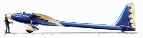

KhAI-Aviavnito-3 to (the scheme) and after (photo) modifications, initially (1936) was a short version - 5 meter cabin for 6 persons each, in 1937 they have been lengthened, thus increasing the payload.

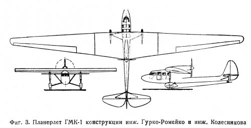

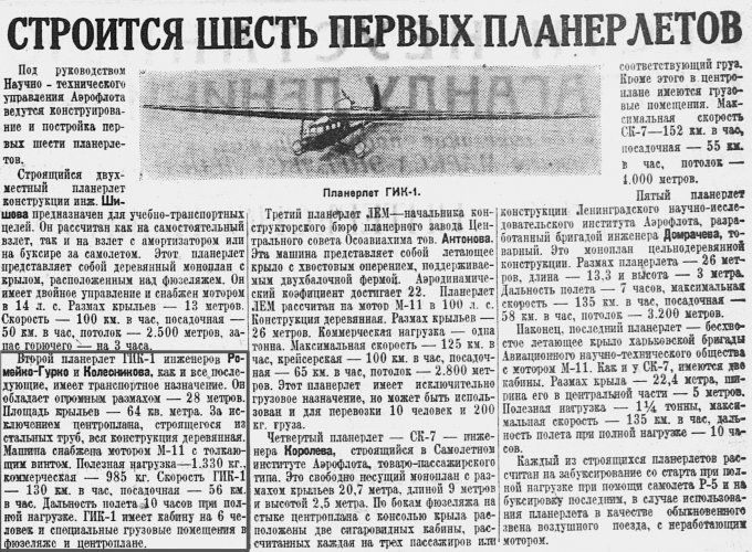

RMK-1 drawing is finally found!
It was published in Tekhnika Vozdushnogo Flota (Airfleet Technique) magazine No.6/1935, in the “Planerlets” article written by the author of the whole concept - Lev Malinovsky!
And technical data for RMK-1 (calculated):
Wing span – 30.0 m
Length – 12.4 m
Height – 3.0 m
Wing area – 64 m2
Empty weight – 1170 kg
Payload – 985 kg
Takeoff weight – 2500 kg
Powerplant – one Shvetsov M-11, 5-cylinder radial, 100 hp
Maximum speed – 130 km/h
Cruise speed – 95…100 km/h
Landing speed – 56 km/h
Flight durability – 10 hours with full payload

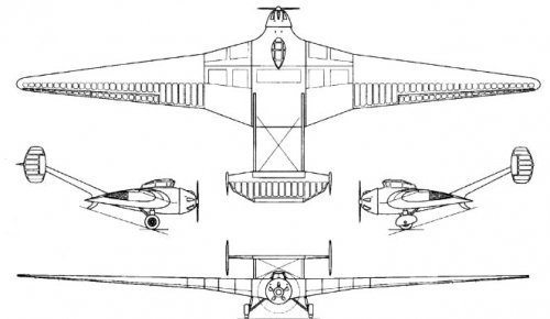

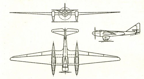

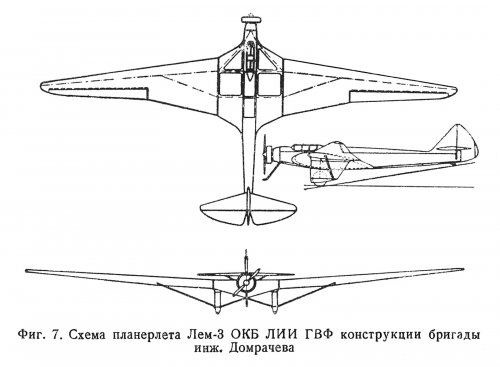

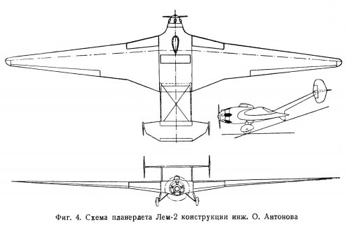

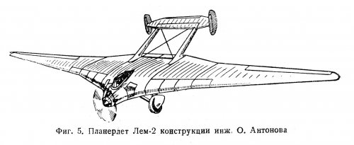

And some more pictures of other Planerlets from the same source (all of them still weren’t built at that time). Note unusual early configuration of KhAI-3, much different from its final layout. In case of Korolev SK-7 - drawing is the same but in bigger resolution.
P.S. It’s curious that Malinovsky in his article calls the designer “Gurko-Romeiko”, instead of more common “Romeiko-Gurko”; therefore the aircraft is also called here “GMK-1” instead of “RMK”. It’s even more amusing that the designer published his own article about some problems of gliders’ designing in the same issue of the magazine – and it is signed “Romeiko-Gurko” :) .

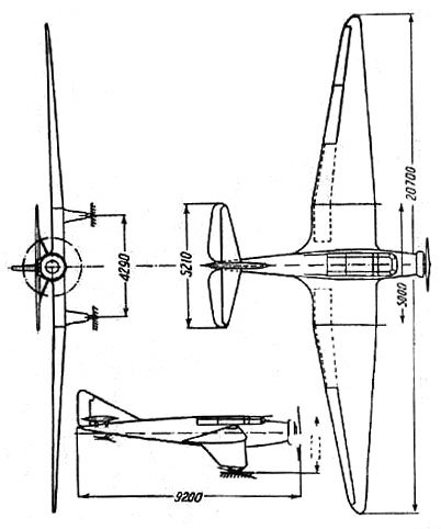

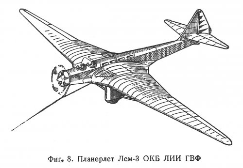

How were gliders with centrally mounted tractor propellers supposed to be towed? The LEM-3 appears to have a frame to keep the cable below the propeller - but what about the LEM-2? The same goes for the KhAI-3 variants which had the engine mounted at wing level, the SK-7, G-31 and the LIG!
Don't know for sure, if the engine of such gliders was intended to be used, when the glider was
towed. Maybe it was installed only to increase the range of the released glider, or to allow for an
easy return after the payload was delivered ?
