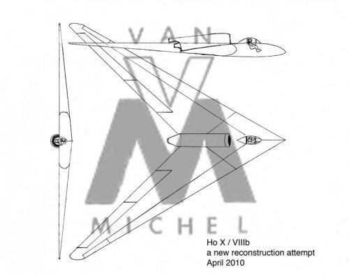

so here my first picture
the reconstruction is on assumption, that is based Ho XIIIa glider

here the picture
index.php
index.php
its the 70° Deltawing reconstruction
and Cockpit filled with WATER !
but no BMW 003 R engine
