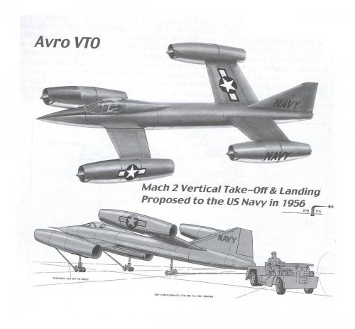

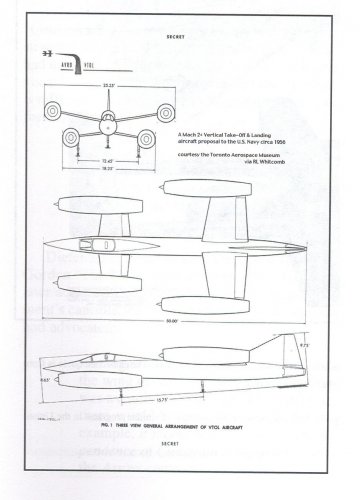

I know that in the competition were:
1) Lockheed CL-349
2) Avro Canada "X-Wing" (Model ?)
I think that in the competition were still other firms, but what I do not know.
That you can add ?

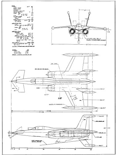

3-View drawing of Lockheed CL-349 (17th variant) M=2.0+ supersonic VTOL tailsitter for USN Type Specification TS-140. Note conventional landing capability (after ventral fin jettison) -- a wise design feature.
I don't think you're interpretting the drawing correctly. The ventral fin isn't jettisoned... it rotates forward.
I'm also uncertain whether it was supposed to actually land this way (using the wheel on the main ventral fin as the nosewheel, and using the two studdy aft ventrals as main "skids"), as it seems like it could only do this *once* and then the structure would be trashed. It might instead have been meant to tilt up and down while on the ground to facilitate crew boarding, though that seems like kind of a waste. Note that the "ground line" reads "static something something service position." It'd be a lot easier to rearm the thing and wipe the birdcrap off the windscreen with the vehicle lowered and horizontal.
