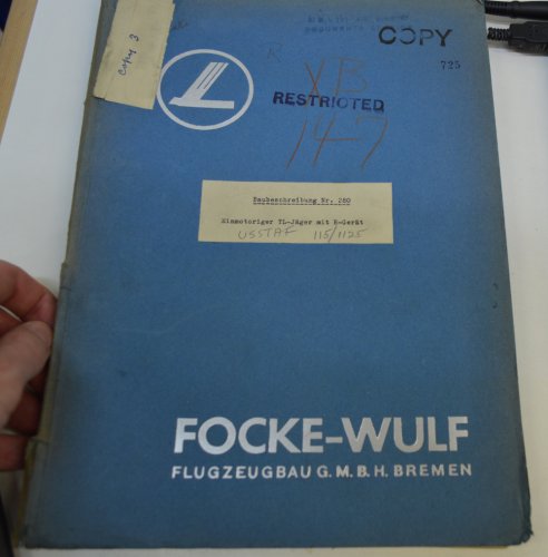

newsdeskdan said:
Nr. 272 Einmotoriger TL-Jäger mit R-Gerät (twin boom single-jet fighter, sometimes known erroneously as the ‘Flitzer’ dated February 1, 1944)
My dear Dan,
even Flugzeug Classic said it was Nr.272.
Focke-Wulf presented its twin-boom jet fighter design to third parties in February 1944 as the Baubeschreibung Nr. 272 Einmotoriger TL-Jäger mit R-Gerät, and later in July 1944 as Baubeschreibung Nr. 280 Einmotoriger TL-Jäger mit R-Gerät (see attached). But I was mistaken when I stated in Luftwaffe: Secret Jets and on this forum that absolutely no period document ever refers to it as the Flitzer. After several years of searching, I have recently discovered a set of internal company memos which make reference to 'Flitzer' or 'Projekt Flitzer' and are clearly referring to that single-jet design. These date from around May 1944 to September 1944.
The Nr. 272 report was dated February 1944 but memos earlier than May 1944 don't seem to use 'Flitzer'.

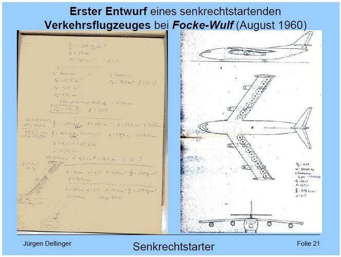

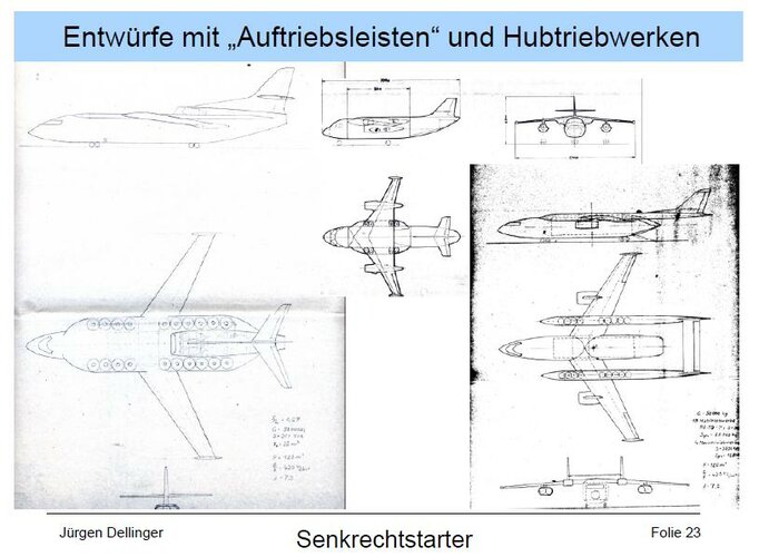

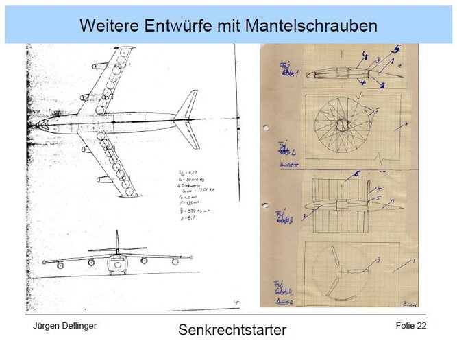

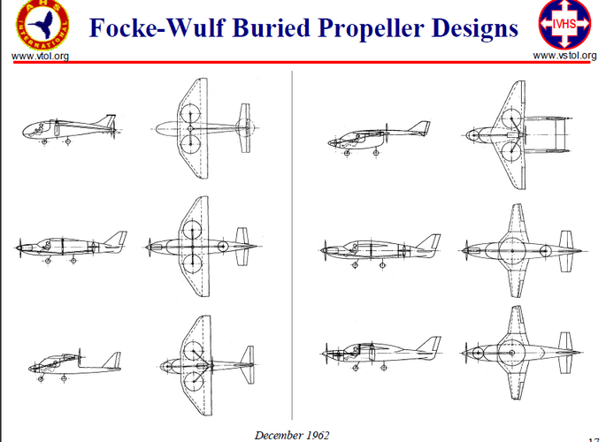

My dear PaulMM,no numerology,
but it's facts we can't deny or ignore,there were many designs for Focke-Wulf,had no numbers
in its designation,such as these concepts,and I have more,but it's not allow to me to publish
them ?.
