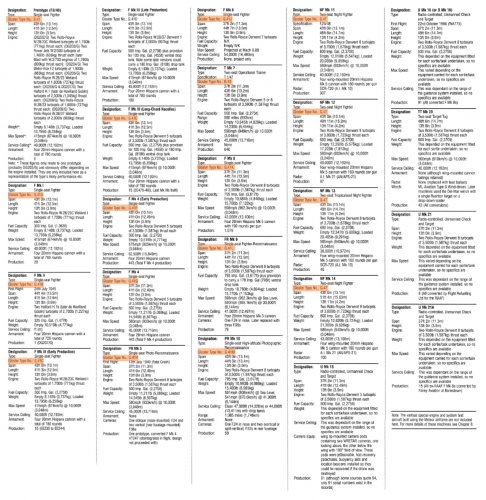

Hi all
New version of the Gloster's P-Series (from Putnam and Midland).
Also fron Putnam: SS.34 - a projected 'monoplane Gladiator' with a retractable landing gear
Regards
  • P Series.pdf

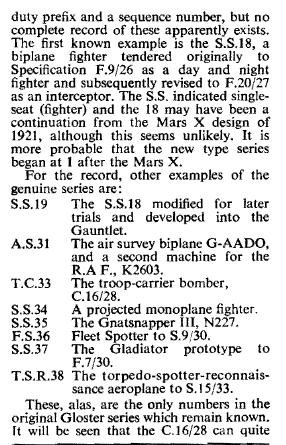

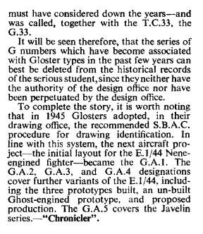

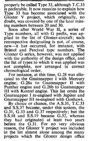

Stargazer,
the source is the Air Pictorial magazine of 1955,I hope many members mention their
sources also,I saw many topics opened,and the sources never mention at all.

Thanks hesham, we don't always remember where we found our information or pictures, but when it comes to designations, it is always best to provide at least a scan (even if we don't know the source) because it proves the validity of the information.
Found the reference to the G.28/Gamecock II association I'd made. It's in a Finnish PDF file. The Gamecock II was a version for Finland, and after the two prototypes, the type was locally built as the Kukko (15 aircraft built). Of course we'd need to have the author's source for the designation, but there remains a possibility that the "28" slot could have been allocated to the Gamecock II in the original (and mostly lost) designation series — or that Finland simply decided to designate as "G.28" their own successor to the G.27 prototypes they purchased...

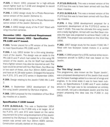

This any help? From Gloster Javelin by Richard A Franks - Verdun Publishing 2006
