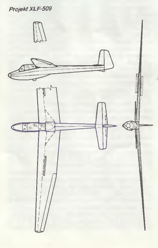

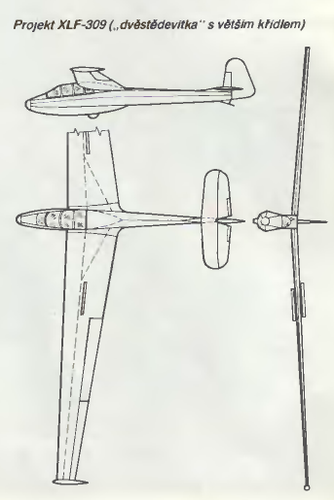

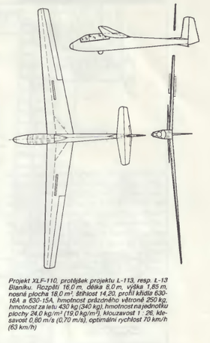

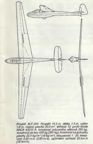

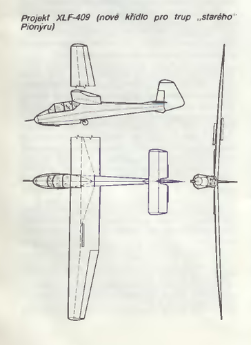

From L+K 17/1983,
here is a small Info about the Projects,XLF-110,XLF-114,XLF-209,XLF-309,XLF-409 & XLF-509.
