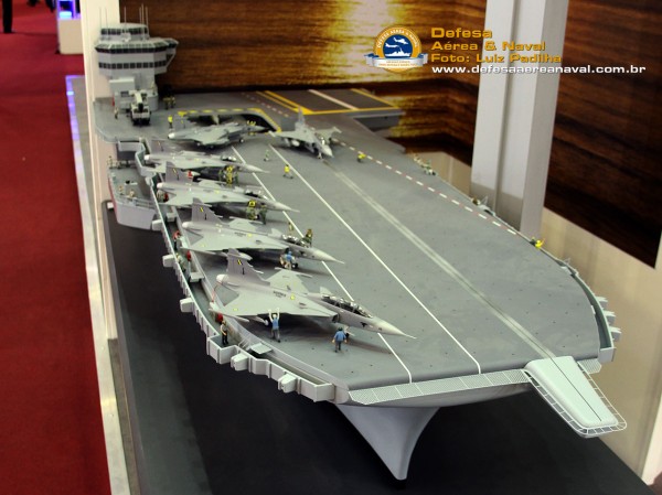

What? They couldn't spend the bucks to make a model of the whole carrier, including the aft end?
Or maybe this is the whole ship and the length of the angle means you're going to decelerate very fast and you really need to hook that #1 wire! B)
Thanks, GTX
