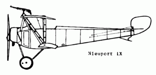

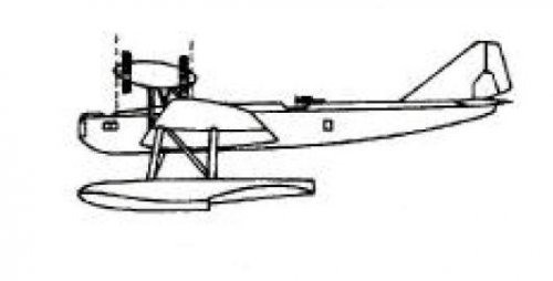

Strange. Here is the Nieuport 60 that I know about:
Impossible Stargazer,
the aircraft you display it was from WW1,and the Nieuport NiD-60 or NiD-600
was here;
http://www.secretprojects.co.uk/forum/index.php/topic,6481.0.html

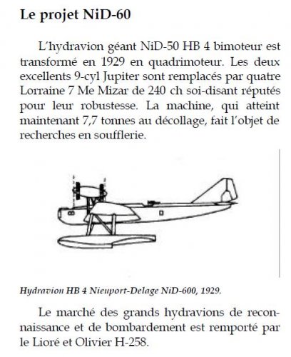

http://tagazous.free.fr/affichage.php?immat=LX-NIE
for the Nieuport Ni.60,here is an article from Hydroretro site;
They are the same,the LX-NIE was a private aircraft from Ni.28;

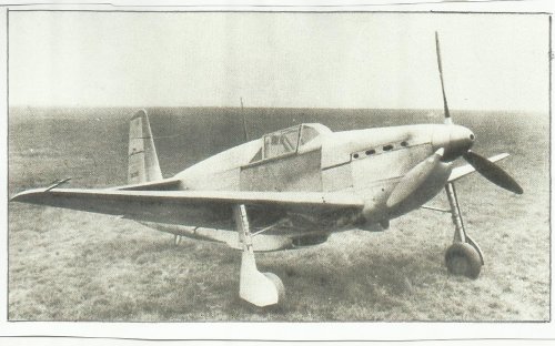

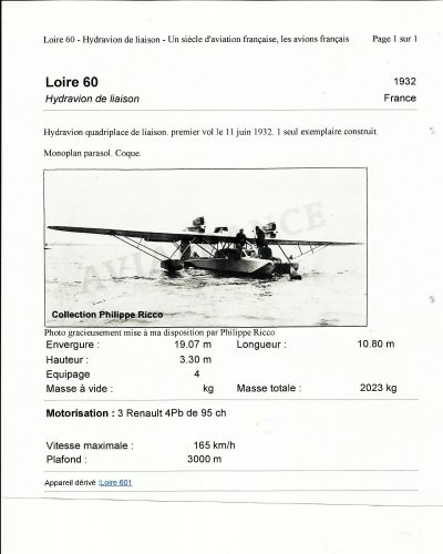

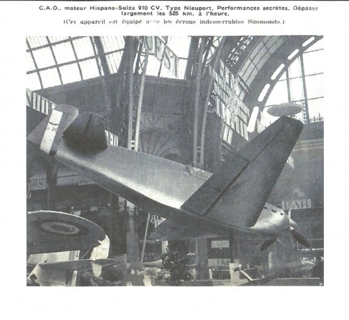

HI ALL
Iknow the loire 60 Hydro
(From Aviafrance)
and the Loire Nieuport 60 Figther
(From an old "Aviation Magazine)
Always at the "Grand Palais" air show
the LN 60........but.....on the tail fin we could
read the number 200 !

My dear Jemiba,
please look to the end page at the second table,many aircraft in Nieuport
designation were taken the same reference,such as Ni-560 means Ni-56,
Ni-640 means Ni-64,and for the Ni-60,you would see it as it written in
the heading.

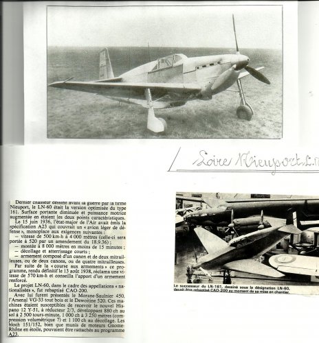

Gentlemen,
To set things clear:
From :Aviation International magazine No 723 - 1 to 14 février 1978
LN 60 (C1-1937) Devenu CAO 200
article : Les Avions Nieuport -Jean Liron

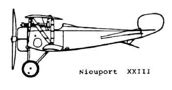

hesham, I hate to be off-topic, but from the following profile (taken from the same document as the LX), you can see clearly that the letters indicate a TYPE NUMBER. In this example, the Nieuport 23 (XXIII). Nothing to do with Luxembourg!
My dears,
this aircraft which Stragazer displayed it,was from WW1 or after it immediately,the
Nieuport NiD-60 was not re-allocated,simply it was not use by that time,and I said
before many countries used Nieuport aircraft,but with there designation,again such
as Nieuport 110 and Nieuport 11000.

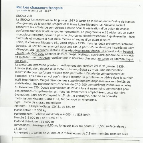

Hello, I'm the author of the post you have cited.
I agree completely with you about the "complexity" affecting the type numbers in the Nieuport aircraft production.
As an help for you is to remember that the Roman numeration was used in the Nieuport company only before 1918.
The designation Nie XXIX was changed to Ni D 29 C1.
The D is for engineer Delage who was the CEO of the Nieuport company.
This system was in use until the Ni D 121, 122, 125, 225 fighters.
In 1933, engineer Delage had left his company.
The Loire yards company purchased the Nieuport one in the same year, but the two aeronautical teams stayed independent.
The Nieuport 161 was designated as Loire-Nieuport 161 only after the discarding of the Loire 250 fighter in 1936. The LN 40, 401, 402, 411 and 42 dive bomber were clearly issued from the LN 161 fighter. The NC 1080 jet carrier fighter share some characteristics of the LN 42.
In January 1937, the Loire-Nieuport company was nationalised as the SNCAO, and the projected Nieuport 60 became the CAO 200.
From this fighter, the hydro fighter CAO 500 and the aircraft carrier fighter CAO 1000 were directly issued from the CAO 200, as also the CAO 810 dive bomber project.
At first,I am not mixing between Nieuport LX registered number and Nieuport NiD-60,second
thank you Aviadrix for sharing,and I want to explain your words; (and the projected Nieuport 60
became the CAO 200),it means; and the projected Loire-Nieuport LN-60 became CAO 200.

A bit more info about and some sources.
Translated from the French text in AviMag. 720 - 16.12.77
... last pre WWII fighter design by Nieuport ,the LN 60 wa the optimised
version of the type 161...

... produced to compete with the Dewoitine D.520 and exhibited
as - a full scale mockup - during the 1938 Salon de Aéronautique.
From AviMag 723 : "Les Avions Nieuport 1919 à 1940" type list Nie 29 de 1918 a CAO 600 de 21.3.1940
not a single indication of a designation ' LX ' or alike is given nor mentioned .

Hi all
LN 60 = CAO 200
hesham said:
Third,what about CAO 1000,I never heard about it before,can you tell us more about it,
data,drawing ...
Some explanations about the aircraft projects I have told you:
the CAO 500 was a twin floats fighter with a very similar fuselage than the CAO 200, a more triangular fin and rudder, and a wing enlarged by the insertion of a rectangular central section.
The CAO 1000 would have retained most of the solutions used for the hydro fighter CAO 500.
