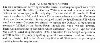

Stargazer2006 said:
As for 10/20, I realize I have the Boulton Paul P.20 listed in my own files...
From Boulton and Paul Aircraft since 1915. Spec references are 05/21 and 10/21.
Cheers Bailey.

Ok my dear Bailey,
I will correct the Spec. 10/20 as;
10/20 DH-29
hesham said:
Ok my dear Bailey,
10/20 DH-29,Poulton & Paul P-20
That's NOT what Bailey said!!! He just said that P.20 was for 10/21, NOT 10/20!
And please... It's BOULTON, not Poulton!!!
Also mind the use of the hyphen sign... "-" was used only by Blackburn on a regular basis, and a few projects by others here and there, but mostly the English government and manufacturers used the full stop sign "."

Bailey, didn't you say earlier in the thread that the Boulton & Paul P.20 was also proposed for 5/21?
Don't worry, a suitably abashed Bailey has amended his list ;D

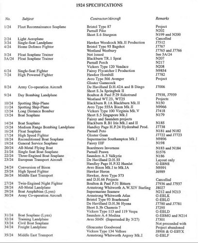

For 1924;
1/24 Parnall Pike,Bristol-87 three-seat recce,Shorts S.6
Sturgeon
2/24 -----?
3/24 Hawker Woodcock
4/24 Bristol-95 Bagshot,Westland Westburg
5A/24 Vickers-120 Vendace,Blackburn TR.1 Sprat,Parnall Perch
6/26 Fairey Flycatcher I
7/24 Hawker Hornbill,(Fairey Fox),Avro-556 single-seat fighter
8/24 DH-42A & B Ding,Shorts S.3a Springbok II
9/24 Boulton & Paul P-29 Sidestrand,Westland WT-23 & WT-25
day bomber,
10/24 Blakburn R.1A Blackburn II
11/24 Avro-555A Bison MK.II
12/24 Vickers-100 Virginia MK.V,Vickers-108 Virginia MK.VI
13/24 Shorts S.1 Singapore MK.I
R14/24 Blckburn RB.1 Iris
15/24 HP-24 Hyderabad
16/24 Parnall Peto
F17/24 (Bristol-102),Gloucester Guan
R18/24 Supermarine Southampton MK.I
19/24 Fairey F.IIIF,(Shorts S.6 Sturgeon)
20/24 Beardmore Inverness
21/24 Parnall Prawn
22/24 Saunders A.3 Valkyrie
23/24 HP-32 Hamlet,DH-55
24/24 Avro-555 Bison MK.IA
25/24 Hawker Heron
26/24 (Avro-563),Avro-573 ME Transport,De Havilland,Hawker
27/24 Boulton & Paul P-31 Bittern
F28/24 AW.XIV
29/24 Supermarine Seamew
30/24 Vickers-113 & -119 Vespa,AW Atlas,Bristol-93 Boarhound
DH-56,Shorts S.3B Chamois
31/24 Saunders A.4 Medina
32/24 Avro-504N
33/24 -----?
34/24 Gloucester Goodwood,Vickers-134 Vellore
35/24 AW Argosy MK.I
Very important notes;
for the aircraft between brackets; Fairey Fox,Bristol-102 Shorts S.6
and Avro-563,I am not sure about them,their sources are from books
and magazines.
For the 1924 competition for two seat light aircraft,which its tenders
were; Bristol-91 Brownie I & II,Cranwell CLA.2,Beardmore WB.XXIV Wee Bee,
Westland Wood Pigeon,Westland Widgeon,ANEC.II,Shorts Satellite,
Supermarine Sparrow,Avro-562 Avis,Blackburn Blue Bird,Hawker Cygnet I
& Cygnet II,Vickers-98 Vagabond,Parnall Pixie III & IIIa and Bristol F.2B Fighter,and I suggest it was the missing Spec. 2/24.

- For 7/24 I also have the Fairey Firefly and Fairey Fox listed.
- I've also got the Blackburn R.B.1B Iris III and the Short Singapore for 13/24.
