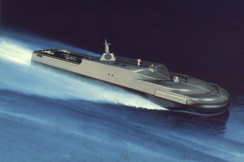

Some interesting Bell and VT designs came out in the 1960's, I dare say not that practicable. However it is interesting to see how the defense industry saw the future, very often the future we describe, ends up the future we have.

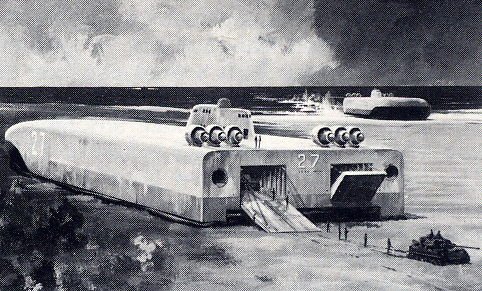

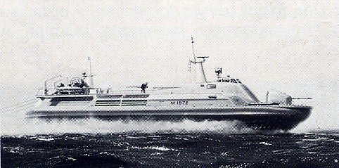

Hello ! would you have info on that saucer-ish Bell hovercraft with torpedo-lauvhing habilities (depending on whom you ask in the nose or in the wings) that finally appeared in the french gravic-novel "panique à cape Kennedy" (Dan Cooper) ?
JCC

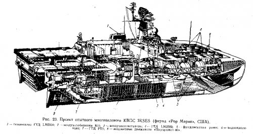

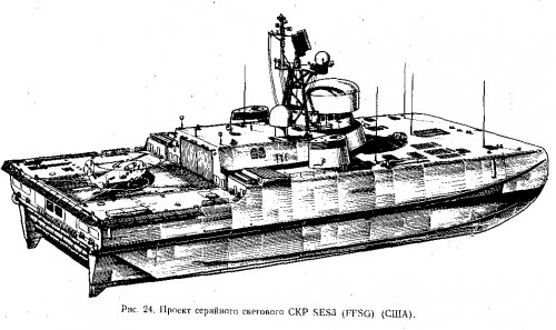

Presumably these were part of the broader USN effort to develop a SES that lead to the "3KSES" - a 3000 ton SES ASW FFG.

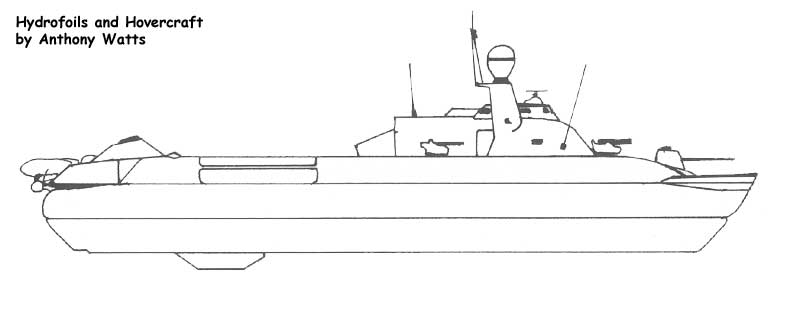

UK 75
Slight threadjack. SARO also investigated hovercraft, of course. A presentation of their work was given at the Royal Naval Staff College, Greenwich, on 1960-02-19. In with the notes from this (which outline some design concepts) and the minutes of an MoS meeting a month earlier (which covers general research) was this beauty:
SARO picture # F1237

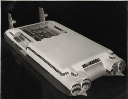

JAZZ, is there by any chance, any more information available on the "US- Bell Amphib Assault LC-1973" concept?
Firefly said:
JAZZ said:
US Assault ship concept
Is that an LCAC on the aft deck?
Looks like it, or rather, a depiction of an operational version of the JEFF B AALC (Amphibious Assault Landing Craft) prototype that would go on to form the basis of todays LCACs.
EDIT: USN LCAC Fact File

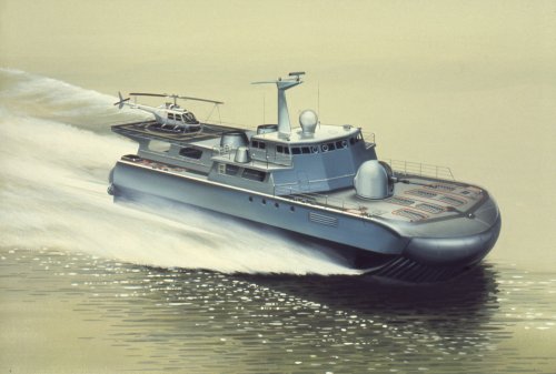

Artist's impression of Bell Aerospace 10,000-ton helicopter carrier hovercraft with Knox-class U.S.S. Roark (FF-1035) for scale circa 1975.
http://www.flightglobal.com/pdfarchive/view/1975/1975%20-%200017.html
That "10,000-ton" ship can't be right. It's no longer than the Knox in the background; although it's wider, it's also quite light, because most of the space under that skirt has to be empty. I'd guess that this is actually Bell's 2,000-ton concept.
Alternate theory: terrible artist.
Stargazer2006 said:
Triton, both images already appear at the beginning of the same page!!!
The images posted by JAZZ are cropped. I would argue that the inclusion of the U.S.S. Roark in the artist's impression or the inclusion of the Chinook helicopters in the other artist's impression is important to gauge the scale of these concepts and adds to the discussion.
The caption in the Flight International article does mention that Bell Aerospace is designing a 2,000-ton hovercraft. Though judging by the side walls in the hull I would guess that the concept is a Surface Effect Ship (SES) or side-wall hovercraft. The concept also does not have hangers, which makes the claim that the concept is a helicopter carrier dubious.

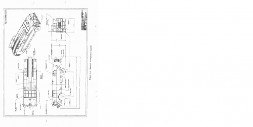

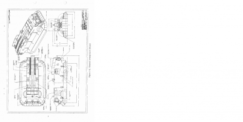

This was actually a project for the Air Force , but I think it fits in here; the Air Cushion Crash Rescue Vehicle.
1.0 INTRODUCTION
This report describes the results of an Air Force program to
develop an Air Cushion Crash Rescue Vehicle (ACCRV) conducted, under contract
FY1456-85-02073. This contract included three phases of study; Concept
Design, described in the Phase 1 R&D Design Evaluation Report, No.
7646-927001 (Ref. 1), a preliminary vehicle design described in Phase II
Preliminary Design Report, No. 7646-927003 (Ref. 9), and a third phase
effort, consisting of design and fabrication of a scaled Dynamic Model of
the ACCRV. The contract included a functional checkout of the dynamic
model, the results of which are included in this report (Section 11.3).
1.1 General
Current aircraft fire and rescue vehicles, including the P-
19, have limited capability to operate over rough and low strength ground
surfaces, especially soft, wet ground or marsh and snow, with no capability
for overwater operation. In a wartime environment, fire fighting and rescue
will be further restricted because of craters, debris or unexploded
bombs.
Improved fire fighting and rescue vehicular mobility is
needed to increase the probability of successfully rescuing crew and passengers.
This requires a radical departure from current fire and rescue
vehicle designs. The successful operation of ACV's over austere surfaces,
including swamps and water, suggests this technology be used to develop an
air cushion augmented fire/rescue vehicle, and this is the basis for the
current effort. The air cushion crash rescue (ACCRV) vehicle is required
to perform a complete rescue from downed aircraft, by traversing a wide
variety of surfaces. It incorporates a triage compartment, a high boom for
access and a slide. Fire fighting equipment similar to the P-19 is also
carried on the vehicle, but it can function as a rescue vehicle as well as
a fire truck.
In the concept study completed during the initial phase of
the program, Bell considered many variations of subsystems and components.
The ACCRV concept design employed major components of the most up-to-date
crash rescue trucks. It was similar in aspect to the P-19 'Rapid Intervention
Vehicle' design specifically for fire suppression but it was somewhat
larger, especially longer, had a more powerful engine, and incorporated an
air cushion system which could be immediately deployed to completely support
the vehicle for off-runway or overwater operation, and a combined
overwater/overland drive consisting of four wheels and a small track system
to augment vehicle propulsion in snow and over water. Its predicted performance
met or exceeded all aspects of the requirements.
EDIT: On reflection, maybe this could have gone over in the ATTS/ACET thread instead.

From "Der Flieger", February 1961, concepts for an attack craft and a hovercraft
to supply submarines at sea.

Good Day All -
I recently bought a set of slides on EBay that were Bell Aerospace conceptual artwork for a variety of design types. Not sure what programs the attached concepts represent - any suggestions?
Enjoy the Day! Mark

Nice ones Mark, thanks! Looks like FV-12s on the flight deck in the fourth pic BTW.
I don't know if any are from actual programs, they have the look of more general promotional artwork.

The second and third are definitely from some SES escort studies that were done in the 1960s. Not sure if they were strictly internal IR&D work or in response to Navy study tasks.
The Last one is the LVA, which was definitely a real concept, discussed here:
http://www.secretprojects.co.uk/forum/index.php/topic,3666.0.html
The first picture makes me wonder whether it would really be possible to land a helicopter on such a speeding hovercraft, in the turbulence of the bridge and other things in front of it?
Or is this only a more-or-ingenuous marketing representation?

The third image is an illustration of the 3,000 ton (3,050 tonne) LSES frigate in operation alongside two Spruance class destroyers (one of them seems to be the USS USS Hewitt) in heavy weather conditions. Presence of Phalanx CIWS on the LSES strongly suggests that the image is actually from the second half of the 1970s (likely late 1977/early 1978, the timeframe when the basic design of the LSES was frozen & the Phalanx was approved for production).
Oh, you're right about the timing; I was off a decade. Is LSES (Large SES?) related to 3KSES or were they separate efforts?
It also appears to have four banks of VLS cells.

Looks like pre-MK41. Basically the Mk 32 Standard Missile coffin launchers turned vertically, I think.
Yes, they were both under Surface Effect Ship Program Office PMS-304; originally 3KSES was intended to test technologies and concepts for LSES, among other programs. However, when the LSES program's schedule was moved up (probably due to a perceived impending escort shortage) it left the planned launch dates of the 3KSES and the first unit of the LSES close together, which led to a rather unfortunate impression that the 3KSES was now a 'prototype without a clearly defined mission'. This led to 3KSES being cancelled in early December 1979 just three weeks prior to start of hull construction. Even more unfortunately, despite the urgent need for the LSES, it too was cancelled in turn in January 1980, at the direct instigation of the so-called 'Carrier Mafia', who saw LSES & the SES program in general as a major remaining obstacle to the procurement of more Nimtiz-class CVNs (more than likely they also were in the background on the 3KSES cancellation, setting the stage for their ambush on the LSES).

I see that more as a high speed transit, not actually launching the helicopter at those speeds.
Thanks too for the potential programs these represent - will revise the file names accordingly.
