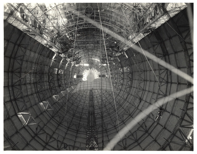

I'm not quite sure if this is the right topic, but here are some photos of USS Akron (ZRS-4) recently posted by the US National Archives at their Commons photostream on Flickr:
http://www.flickr.com/photos/usnationalarchives/sets/72157631511771730/with/7951496116/
A couple of samples:
Not quite the right topic indeed, but beautiful nonetheless! Thanks.

Came across more photos of the Akron over at the San Diego Air & Space Museum (SDASM) Archives on Flickr - (Glenn W. Bates album). With respect to this topic, this photo intrigued me. The photo was taken inside the Goodyear Airdock during the construction of either the USS Akron or USS Macon, and it features a representative model / construction model of the airships. (EDIT: The photo also appears to include designer Karl Arnstein). On the side of the model it says "Goodyear-Zeppelin," as one might expect. However, the lower tail-fin carries the designation "RM-7A". Any ideas if this is a design number? Google has failed me after searching variously and in combination for "USS Akron", "USS Macon," "Goodyear-Zeppelin," etc., and, of course "RM-7A." :-\
Here's the photo in question:
View: http://www.flickr.com/photos/sdasmarchives/10561645964/
And here's the link to the largest resolution version of the of the photo, where one can clearly see "RM-7A" on the lower tail-fin.
View: http://www.flickr.com/photos/sdasmarchives/10561645964/sizes/o/

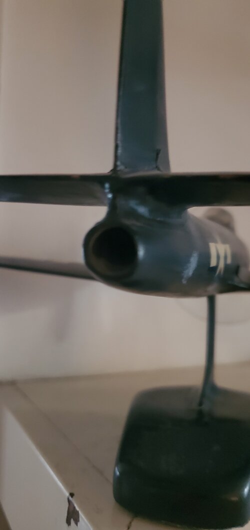

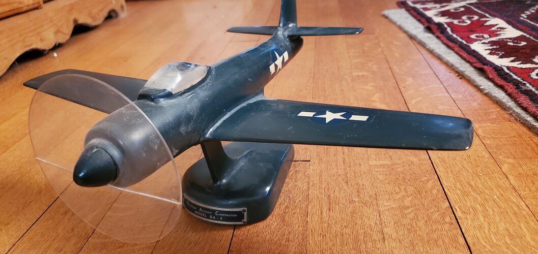

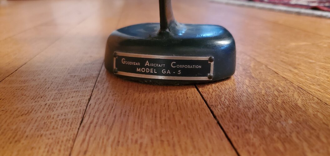

My late father-in-law was an engineer for GAC during WWII and played a major role on the development of the F2G. Among the things we found after he had passed was a wooden model of a proposed GAC aircraft that is labeled as a "GA-5" and one that certainly looks as if it was intended to be a rival bid for the Ryan Fireball (i.e, propeller upfront, jet exhaust in the rear of the fuselage). Can anyone shed any light on this?
My late father-in-law was an engineer for GAC during WWII and played a major role on the development of the F2G. Among the things we found after he has passed was a wooden model of a proposed GAC aircraft that is labeled as a "GA-5" and one that certainly looks as if it was intended to be a rival bid for the Ryan Fireball (i.e, propeller upfront, jet exhaust in the rear of the fuselage). Can anyone shed any light on this?
Do you still have this model? Or, by chance, took a photo of it when found?
We seem to have found little about the GA-5. Tommy Thomason speculated that the GA-5 may have been a rather late, unsolicited proposal (the concept being submitted after the Ryan FR had already flown.
