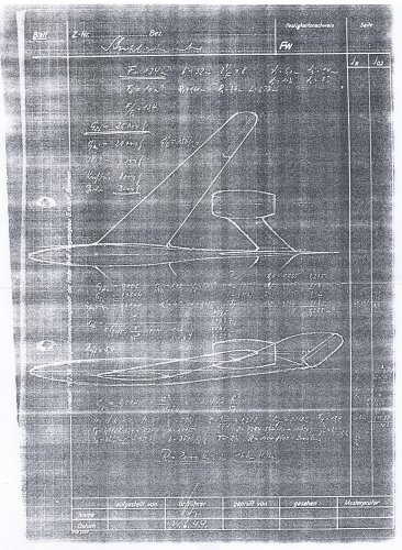

A "Luft '46" fan site suggested a missile not unlike a Rheinbote with a Pabst ramjet hung onto it as the "V-4". While the notion of such an arrangement is not much of a stretch, there wasn't any credible evidence to it actually happening, other than vague mutterings of little documented launchings into the Baltic and such.
The only other data on the ramjet I've seen was some miniscule bits on wind tunnel tests and the FW Treibflugel and a few other proposed applications.
Length 2700 mm.
Diameter 1440 mm.
From "Reichdreams " N.19 and
"Die Deutschen Raketenflugzeuge" by Joachim Dressel & Manfred Griehl , Motorbuch Verlag 1989

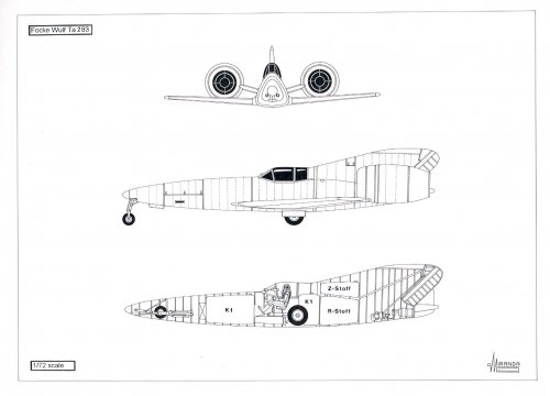

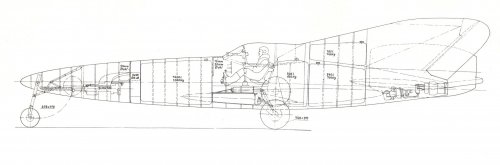

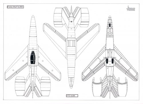

This is Ta Bomber and I have done these pictures for David Myhra ten years ago. Maybe more in his books. It is known Ta Fighter, too.
Nice to meet you :)
Ta 283 ramjet/rocket fighter and the other version which is usually mentioned as "Super Lorin" are well known . But this two-seat bomber version is new to me.
Did you make the model based on plans/drawings?
Nice to meet you :)
The "Ta 283" designation quoted for the Strahlrohrjäger twin-ramjet fighter is an invention by some aviation historians derived from drawing number Nr. 283 for the Strahlrohrjäger as noted by Dan Sharp in his book Secret Projects of the Luftwaffe, Volume 1: Jet Fighters 1939-1945. Sharp also notes that the evidence for the Super Lorin being a Focke-Wulf design is rather weak, with the name of Focke-Wulf engineer Heinz von Halem (designer of the Focke-Wulf Triebflugel) appearing on the Super Lorin project drawing.
