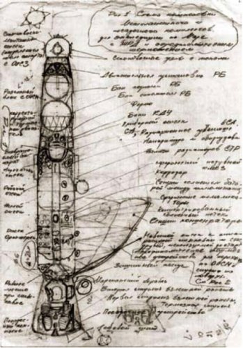

Picture from extracted PDF

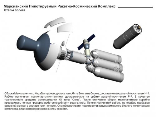

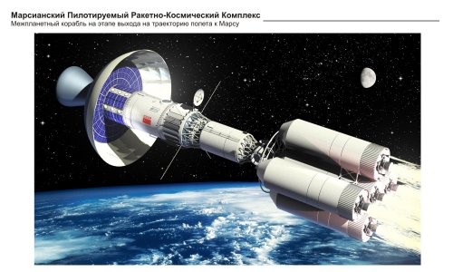

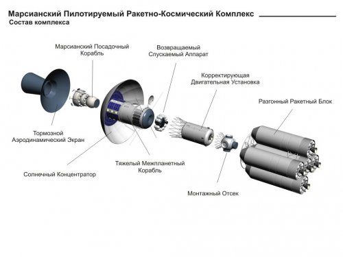

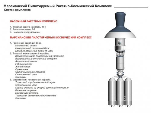

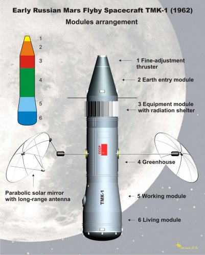

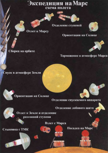

I study that theme about two years and I can say it is true. I met the author of the book “Marsianski projekt S. P. Koroljowa” – Vladimir Bugrow. He was as main engineer (lead engineer) in OKB-1 on that project during 1961-1964. He detailed explain evaluation of mars ship TMK to MPRKK. I made some illustrations about that theme. You can see it below. Many illustrations now not finished – I want show all steps of mars expedition. That work is in development.
Also I want make focus on one important think: at first in OKB-1 was project of Manned Mars Expedition 1960-1964 (N1-TMK/MPRKK). Then was project of Manned Lunar Expedition 1964-1974 (N1-LK3). From 1966 (the Korolev died) the Manned Mars Expedition project moved from OKB-1 to NII-88. Those projects called “MAVR” and “AELITA”.
My illustrations regarding that theme (DRAFT, NOT FINISHED! so, please not use in any publications!) ONLY FOR SECRET PROJECT FORUM:

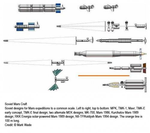

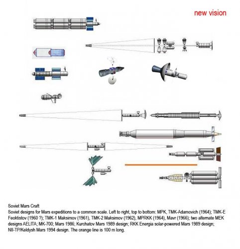

I want to make clear something:

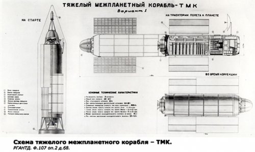

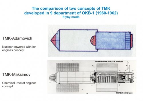

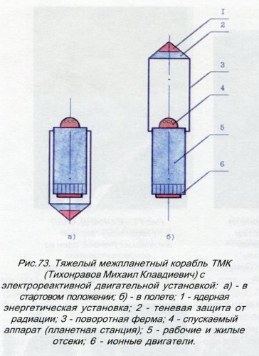

1. On Mark's illustration there are no some variants of the ships. That I presented above I add one more concept. It is the ship with a nuclear reactor and ion engines which was studied in 9 department of OKB-1 in sector of Adamovich. This illustration is taken from his book. The draft project was ready in 1962 and described the ship in a general view. This ship no concern to TMK-E of Feoktistov.
2. One of the ship Mark called "TMK-E early concept". But it is not so correct. Simply it is similar to TMK-Adamovich ship and I suppose Mark mixed the ships (TMK-E means electric ship with ion engines). Actually it is the concept of ТМК ship studied during the same period in sector of Maksimov. That TMK have to departure from Earth orbit to Mars by chemical rocket engines. The comparison of that ships presented below.
So, I updated Mark's illustration. It will be more exact. It is my vision and can be not finally.

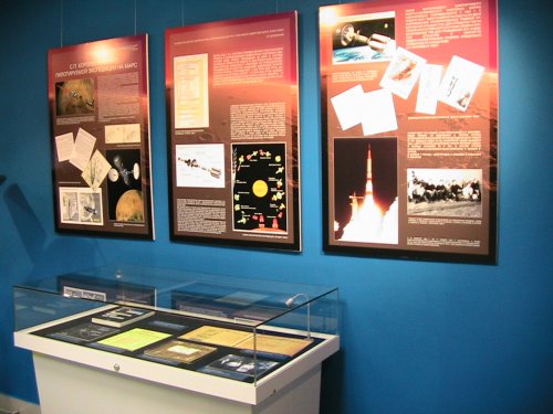

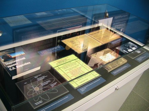

1-st September in Moscow in the Memorial MUSEUM OF COSMONAUTICS there is presented some exhibition "Forward to Mars!" (Âïåðåä íà Ìàðñ!). There are 3 of 15 stands show the Soviet project of manned expedition to Mars developed by S. Korolev (1959-1974). Unfortunately I have photos with poor quality.

The design with the hinge is interesting, to get the reactor away from the crew I presume?
