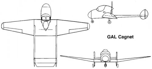

Missing twin-boom prototypes like the GAL-33:
GAL-47 Flying Observation Post : single engined (see http://1000aircraftphotos.com/Contributions/DeRoeckJoris/4805.htm )

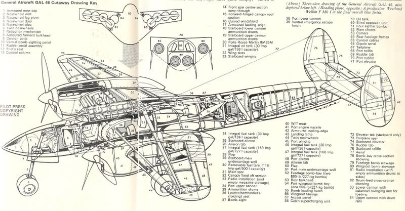

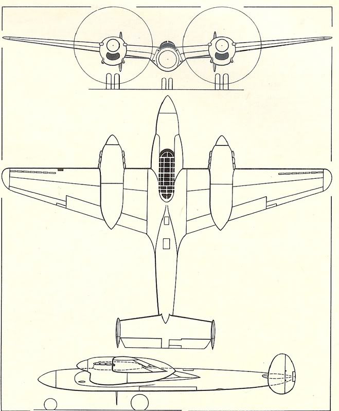

GAL 46 proposal - 3 View & Cutaway drawing:
Regards,
Greg
Very nice -- especially the cutaway. Thanks Greg!

In that case, how much veracity can I ascribe to the attached 3-view ,
from page 194 of 'British Light Aeroplanes-their evolution, development and perfection, 1920-1940'?
Regarding the 'GAL.44' type number, I suppose this might arise from the Cygnet being GAL.42,
and the Owlet being GAL.45...
cheers,
Robin.

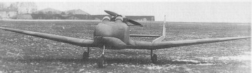

The illustration in Ord-Humes book originally comes from Aeroplane (Weekly) of March 8, 1939, presumably being its intended layout as it was then still being built. Ord-Hume is very fond of quoting from Aeroplane. Don't get me wrong, his books are pretty good, but in producing such large and broad tomes in a relatively short time there will inevitably be mistakes.
The attached can be found in Aeroplane (Monthly) of March, 1996.

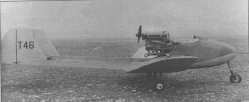

As for flight details, I have:
C/n 106; C. of A application 21.1.39, not issued. Ff mid-1939 as T46, later T-0223. It was allocated W7646, NTU, and was at the School of Army Cooperation in June 1940. Returned to manufacturer, date unknown. Final fate unknown.

That photo was submitted by the late Gordon Swanborough in response to a readers question.
The attached is from Air Enthusiast #93 and appears to have been taken at the same time as the previous photo. Probably also sourced from Gordon Swanborough since he was associated with Air Enthusiast.
The Cagnet is something of a "rara avis" - I only know 3 photos of it, the two I posted and one other that used to be on Jaap Teeuwens web site, but that site no longer seems to be around.

Thank you very much for that....
cheers,
Robin.

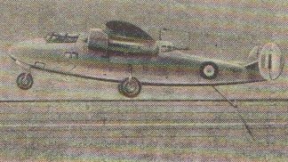

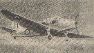

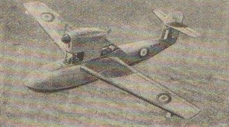

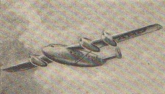

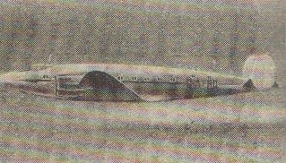

Illustrations from "The Aeroplane Spotter - June 26 1948" Sorry about the poor quality, but better than nothing.
Regards Bailey.
