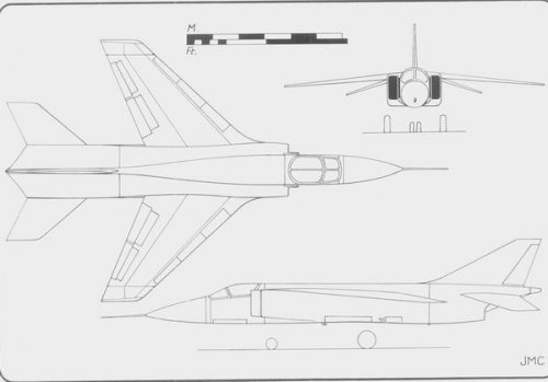

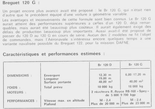

For this program Breguet tendered the Br.120, 3-view and data below :
(The Br.120G was a VG-version of the basic aircraft, I think)
From : J.Cuny "Les Avions Breguet 1940 - 70
Of course, DAFNE was the name of the program... Hey, this Breguet design is new for me! With its 120 number, it just fit between the 1120 Sirocco and the 121 Jaguar! This is very interesting!

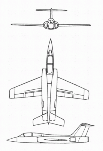

Here's the CTOL Cavalier. I would be glad about a source showing the undercarriage ...
