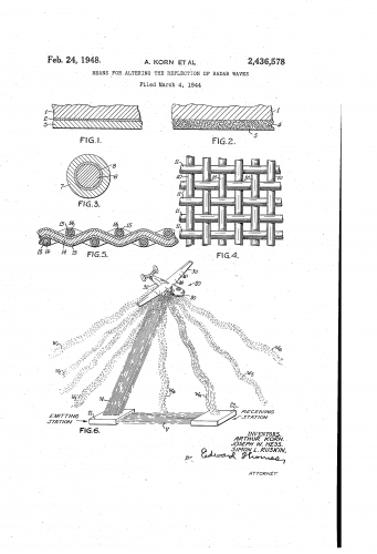

Arthur Korn (et al), 'Means for altering the reflection of radar waves' (US 2436578).
Filed March 4th 1944, http://www.google.com/patents/US2436578
"According to the present invention devices and methods are provided, whereby the measurements by radar become less readily detected. This method in general consists in making the radar waves sent from their source strike upon reflecting surfaces which contain certain electrically semi-conducting material whereby the reflected radar waves are altered and cause thereby erroneous radar measurements."

Just as a quick pendant to the above, note that the Korn (et al) patent device seems aimed very much more at confusing radar returns, rather than trying to achieve genuine radar invisibility. For example "Thus the receiving station 22 fails to receive a normal amount of reflected radio waves from the airplane 29. As a result the correct calculation of position of the airplane is weakened, because waves are directed to W1, W2, Ws, W4, W5, W6, for example" (patent page 3). See attached digram above too.
