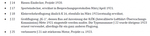

J 14 ; Big monoplane, project
J 15 : Light passenger aircraft for two pax + pilot, 1920, The wing could be changed from
a high to a low position, one built for testing
J 16 : Often reffered to as the pre-project to the K 16 small airliner (?)
J 17 : Sports air:craft, monoplane, mentioned March/April 1921
J 18 : Light passenger aircraft, similar to K 16, mentioned March 1921
J 19 : The later T 19 trainer/touring aircraft, 1922
J 21 : T 21/H 21, parasol twin seat recce aircraft, 1923
J 22 : T 22, single seat fighter version of the J 21
designation seems to have been used twice
J 22 : Large aircraft ("Großflugzeug") JG -1, construction stopped
in 1921 on order of the allied aviation control commision (ILUK)
J 25 : Improved J 21 with more powerful engines
J 40 : Long range twin hull with special equipment (?)
(suggests, that only the equipment lead to the new designation)

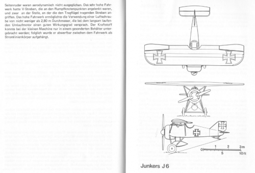

Also the J.6 Info and drawing;

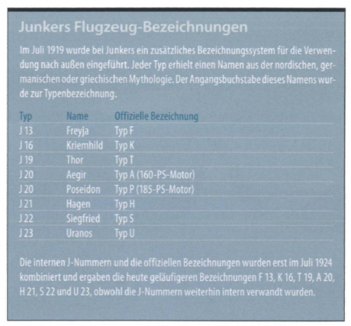

I don't know if this is useful but, according to Lennart Andersson, Junkers type letters (other than J) were, in July 1919, linked to project code names. These were:
J 13 - F 13/Type F (Freyja)
J 16 - K 16/Type K (Kriemhilde)
J 19 - T 19/Type T (Thor)
J 20 - A 20/Type A (Aegir) and J 20 - P 20/Type P (Poseidon)
J 21 - H 21/Type H (Hagen)
J 22 - S 22/Type S (Siegfried)
J 23 - U 23/Type U (Uranos)
J 24 - G 24/Type G (possibly just for Großflugzeug)
"Only in July 1924 the internal designations and the official designations were finally combined to form the more familiar designations F 13, K 16, T 19, A 20, H 21, S 22, U 23 and G 24, although the J-number designations were still retained for internal use."
http://www.artiklar.z-bok.se/Junkers.html
My own chart (below) concurs with what Apophenia shared. Very interesting to finally learn the meaning of the letter prefixes as referring to Norse mythology and such!
Chart removed until updated version replaces it.
