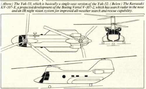

here is the Kawasaki KV-107-X helicopter project,consider a super Chinook,developed
from KV-107-II with many new features,does anyone hear about that beast before or
has anyone a more info about it ?.

It looks like an upgraded Boeing Vertol CH-46 Sea Knight than a Boeing Vertol CH-47 Chinook.
My dear Rolf,
you know Kawasaki took Vertol V-107 Chinook and built and developed it,and KV-107 series belongs
to it,but I agree with you,it looks like Sea Knight.
The KV-107 was a licenced version of the Sea Knight, not the Chinook.
Oh yeh,that's right,sorry.
Boeing Vertol 107 = Sea Knight >> KV-107
Boeing Vertol 114 = Chinook

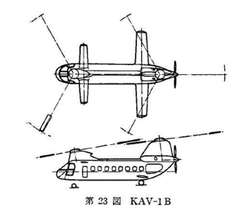

Hi another KV-107 base project. KAV-1B.
Please watch PDF file.
https://www.jstage.jst.go.jp/article/jjsass1953/12/125/12_125_198/_article/-char/ja/

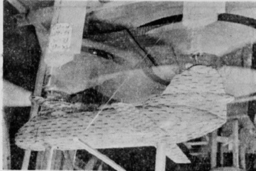

Great find my dear Blackkite,
I heard about it before,but I found no drawing to it,thanks.
Not at all my dear hesham! You are great as usual. ;)
Wingshape is somewhat similar to a later modification of the Bristol Type 173.
But I hope, that in the KAV-1B the rear loading ramp would have been omitted.
Dangers for those, exciting to the rear would have been tremendous ! ;D
Thank you my dear Blackkite,
and for my dear Jemiba,I agree with you,that the rear wing could make a disaster.

From Air International 8/1982,
Those elongated sponsons probably contain extra fuel tanks to extend range.
They remind me of the huge tear-drop shaped extra fuel tanks bolted to the outboard ends of the sponsons on RACF and Swedish Air Force 107s to extend time-on-search during rescue missions.
An exaggerated version is the extra-wide sponsons installed on some recently built military Chinooks.
Meanwhile the civilian Chinooks - that work as cranes - have most of their sponsons removed.
