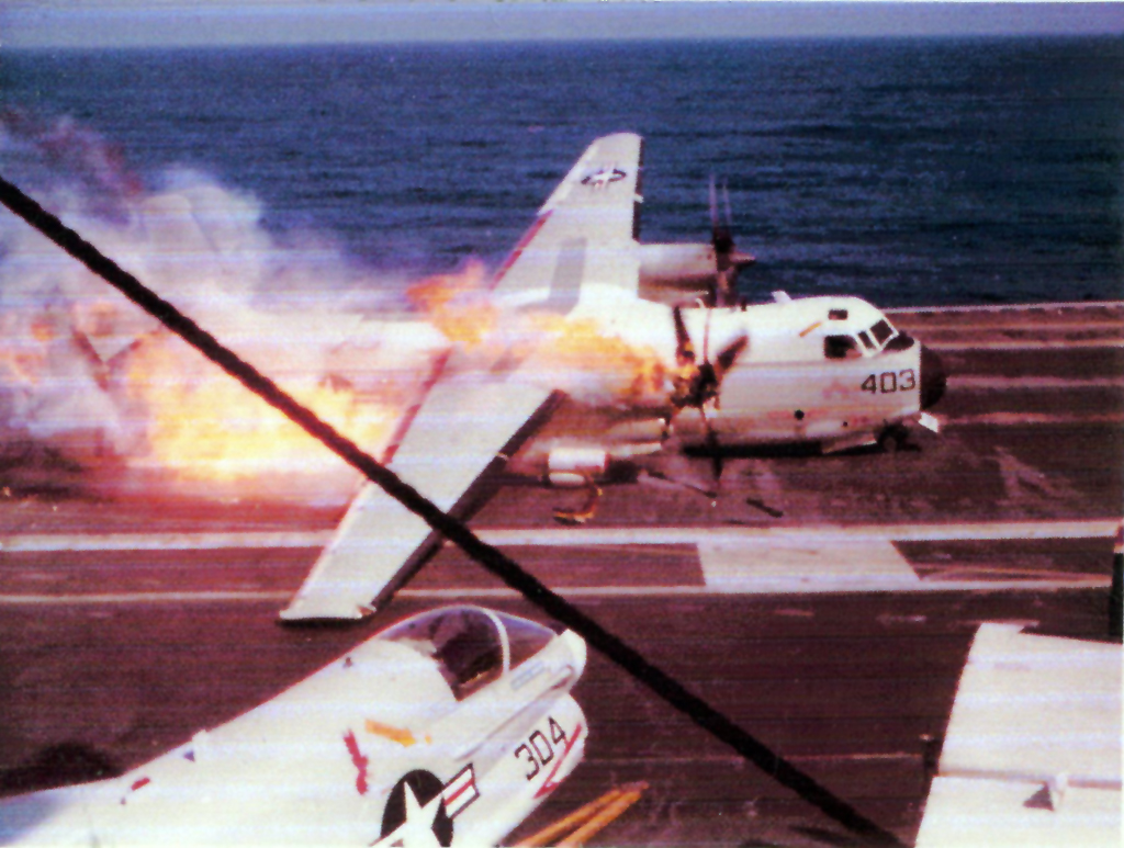

I can't believe Axe only mentioned the V-22s crash record as well:
On 29 April 1965, YC-2A #148147 ditched into Long Island Sound on a test flight, killing all 4 crewmen.[8]
On 2 October 1969, C-2A #152796 from VRC-50 crashed in the Gulf of Tonkin en route from Naval Air Station Cubi Point to USS Constellation (CV-64), killing all 6 crew members and 23 passengers.[9]
On 15 December 1970, C-2A #155120 from VRC-50 crashed shortly after launch from USS Ranger (CV-61), killing all 4 crew members and 5 passengers.[10]
On 12 December 1971, C-2A #152793 crashed en route from Cubi Point to Tan Son Nhat International Airport, killing all 4 crew members and 6 passengers.[11]
On 29 January 1972, C-2A #155122 crashed while attempting to land on the USS Independence (CV-62) in the Mediterranean Sea, killing both crewmen.[12]
On 16 November 1973, C-2A #152787 crashed into the sea after takeoff from Chania International Airport, killing 7 of 10 persons on board.[13]
Thats 61 killed in 6 crashes by my count, can't believe he didn't mention that. :-X
I was about to say that it's not quite fair to compare Greyhound to Osprey when it comes to accidents, because surely there have been lots more Greyhounds built, but according to Wikipedia it's 160 to 58 in favor of the Osprey. I do imagine that the rate of accidents per hour for the Greyhound is much less than the Osprey due to the Greyhound's many years of service.

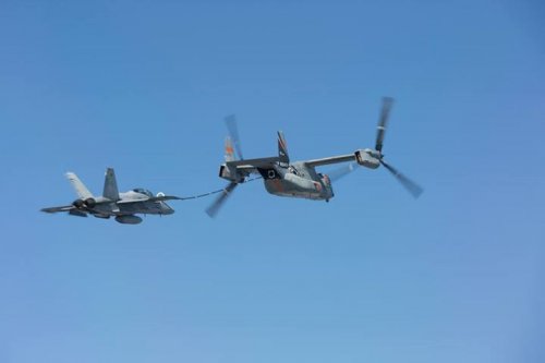

Karika said the Navy also might consider using the Osprey as a refueling tanker for Hornet jets during recovery and launch operations. Bell-Boeing will be testing the Osprey in refueling missions later this summer, he said.
PATUXENT RIVER, Md., Sept. 5, 2013 – The Bell Boeing V-22 Program, a strategic alliance between Bell Helicopter Textron Inc. [NYSE: TXT] and Boeing [NYSE: BA], has successfully completed an initial test of the V-22 Osprey performing as an aerial refueling tanker. Adding this capability to the tiltrotor aircraft would further advance its versatility in combat, humanitarian and ship-based operations.
In the August demonstration over north Texas, a V-22 equipped with a prototype aerial refueling system safely deployed, held stable, and retracted the refueling drogue as an F/A-18C and an F/A-18D Hornet flew just behind and to the side of the aircraft.
“Adding aerial refueling tanker capability to the V-22 will enable operators to execute a wider variety of missions with greater flexibility and autonomy,” said Vince Tobin, Bell Boeing V-22 program director. “This will save time and money by maximizing the efficient use of aircraft and personnel.”
Future Bell Boeing tests will put aircraft in a fuel-receiving position directly behind the V-22, connect receiver aircraft with the refueling drogue and, ultimately, refuel a variety of aircraft in flight. The V-22 is a combat-proven tiltrotor that can fly horizontally at high speeds and high altitudes like an airplane, and take off and land vertically like a helicopter.
http://boeing.mediaroom.com/Bell-Boeing-V-22-Osprey-Deploys-Refueling-Equipment-in-Flight-Test

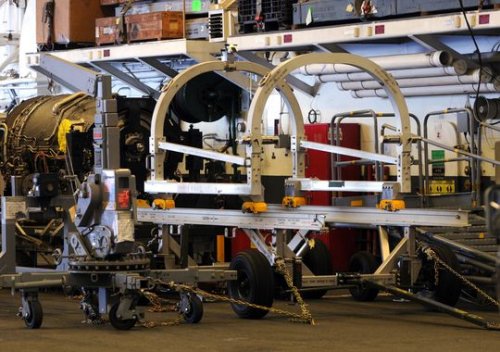

In fact, the biggest and most important question has now been answered regarding the aircraft's behemoth engine produced by Pratt & Whitney. One was successfully brought aboard the Wasp May 20 via MV-22B Osprey tiltrotor aircraft. It now sits in the ship's maintenance hangar.
The successful exercise proved that the engine could be placed on a custom-built cradle that fits in an Osprey without surpassing weight and balance limits that would degrade the tiltrotor's handling beyond acceptable limits.
"One (F135 engine) was successfully brought aboard the Wasp May 20 via MV-22B Osprey tiltrotor aircraft". According to the Reuters report, the V-22 carried only part of an F135. In order for the V-22 to win the COD selection it had to prove that it was able to carry an F135 internally - as the engine doesn't fit into the V-22 load bay, it has to be broken down into five seperate components.
Sources:
http://www.reuters.com/article/2015/05/20/lockheed-martin-fighter-idUSL1N0YB03520150520
http://www.marinecorpstimes.com/story/military/tech/2015/05/26/marine-f-35b-conducts-first-operational-testing-at-sea/27983193/
