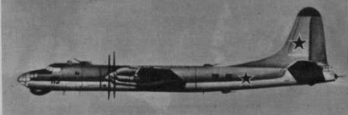

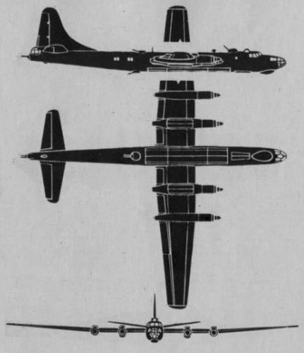

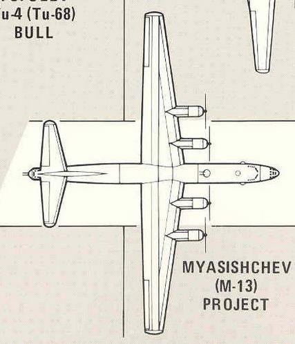

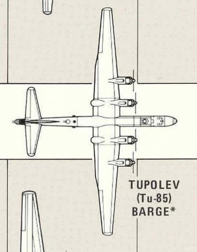

but look with me to those two drawings,they aren't resemble,now I am asking;
if that drawing is not for M-13 (designation incorrect),what is that Myasishchev
design ?.

I don't ask about M-13,may be it was never existed,but I ask about what was this aircraft ?.
I see two possibilities:
1) This is not very correct (and highly oversized) interpretation of some of DVB-202/302/402 projects;
2) This is pure imagination of Western author who thought that "there must have been something like this"...
A large part of the so called information about Russian aviation in the 'West' during
the CW period is pure imagination based on hazy photo's and rumors.
Often made up by intelligence groups.
I remember the big scare of the 'Tug' -6 engined bomber...
I have the book mentioned by Cy on my shelves .I keep it only as a relic of a time gone
and no longer as a reliable source of info.

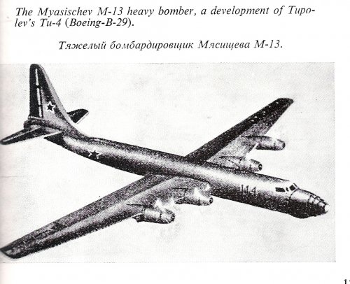

Here is an image of the "M-13" from the Nowarra Duval book .....
The text with the photo reads ..."Under the supervision of A.N.Tupolev , M.V. Myasischev designed a progressive development of the Tu-4 (ex-Boeing B-29) during 1948-1949, designated M-13. Originally intended as a heavy bomber, it was soon re-equipped for long-range reconnaissance flights." The text goes on to claim the type went into production.
Details from the books data tables section:
ENGINE
POWERPLANT TYPE: 4 x Kuznetsov NK-4 plus 2 x RD-45 jets
OMG... The Kuznetsov NK-4 turboprop engine was designed in 1956!
My dears Cy-27,Ucon and Redstar,
that means the M-13 was a real aircraft,and was not a Western incorrect designation
given to a Tupolev aircraft.

In his 1967 book 'Die Sowjetischen Flugzeuge 1941-1966' H.J.Nowarra gives "M.13"
dimensions and estimated performences and even the Nato code name 'Barge'
which was the code name for the Tu-85.
No mention in this book is made of the Tu-80 nor Tu-85.
Hence the source for his confusion and the later mistakes in other sources.

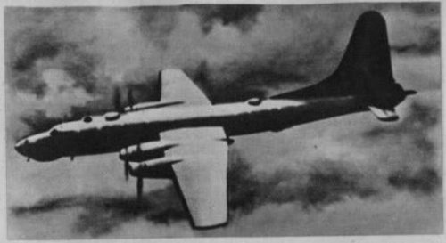

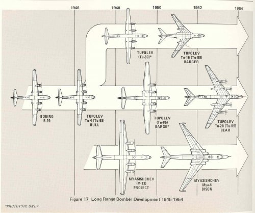

Some drawings about the fake M-13. I can see very clearly it is a misidentification of the Tu-85 by western analysts in the '50s.
It seems Alternathistory was fooled by it as well.
