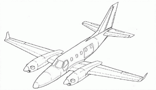

A drawing of the M-201 from the same press release...

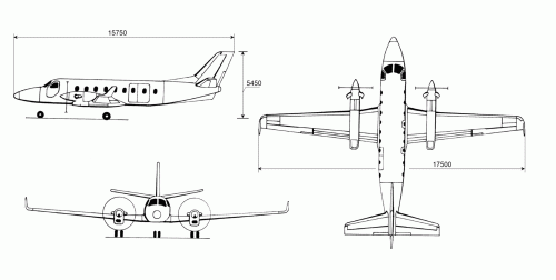

  • Three-view arrangement

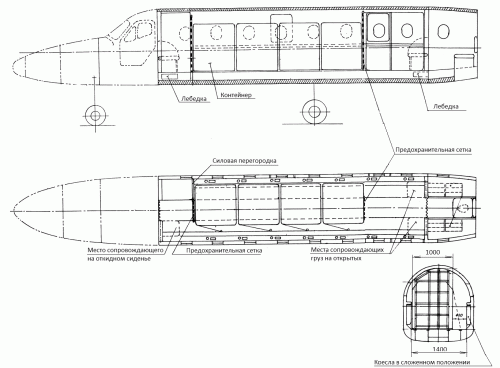

  • Inboard profile (cargo version)

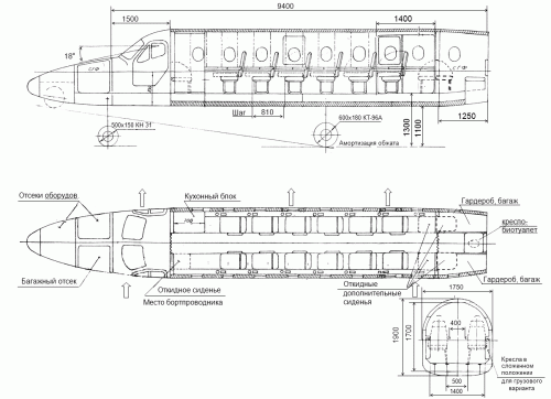

  • Inboard profile (passenger version)
