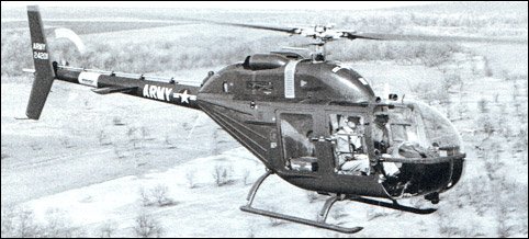

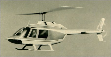

The "shell" of Bell's losing design for the Army's LOH competition, the OH-4, was redone at Bell marketing's behest in accordance with the recommendation of an industrial design consultant to create the Bell 206 JetRanger for the commercial helicopter market. Of course, this is a lot easier to do with a helicopter, since the exterior is more of a facade than it is on an airplane. It's the dynamics (rotor and drive train) and tail boom/fins that are critical.
Absolutely. And when I think of helicopters such as the Cessna Skyhook, Fiat 7005, Hiller 1099 or Doman D.10B for instance, I can't help but think that the odd looks may have been a factor in customer resistance to purchasing them, because they were not inherently bad machines. Reversely, the more successful helos such as the JetRanger, S-76, Black Hawk, Enstrom, Ecureuil and others all have streamlined profiles that convey an idea of speed and efficiency that must be a decisive factory in customer choice.

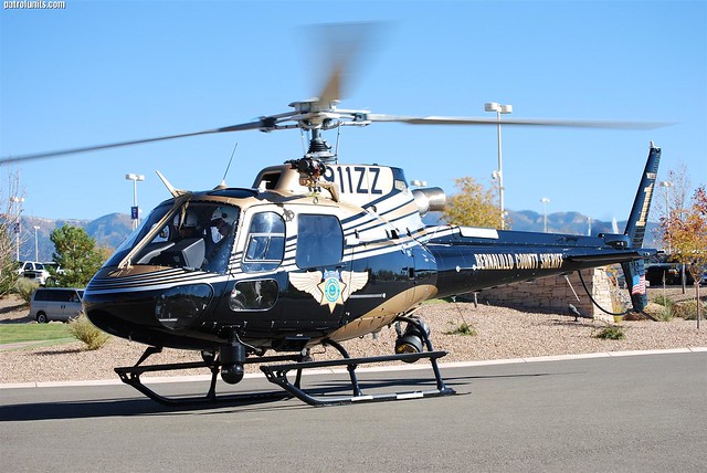

Here is the B3 AStar that "won" the local competition for the new sheriffs helicopter. Looks darn nice B) A pilot I have known for years did the eval flights on it, he liked it because it "had power to spare, and Air Conditioning" I don't know how much his recommendations had in the overall selection. However I do know that whatever those reasons were, the B3 was a "lock" to win and the Sheriffs office had already decided on it but in the interest of making things look fair Bell was invited and brought a 407 out to compete.

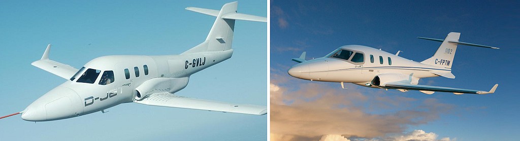

Speaking about my own experience, the Diamond D-JET original prototype was considered as deficient on aesthetics, and it definitely would have hurt sales. So I got the job to redesign it, on the condition that its configuration remains unchanged. In the process, I addressed some issues in ergonomics and inlet aerodynamics.
You can see the original on first prototype the left, and the changes applied to the second prototype on the right with a completely reshaped fuselage and engine inlet:
