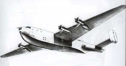

Was the drawing of the Consolidated XPB3Y-1 flying boat project
-SanDiego Air Museum- published somewhere ?
Thanks in advance for a bit more info.
I obtained that some years ago from the San Diego museum after I contacted them. It was all done electronically.

The illustration with Jos Heyman's post (reply#3) shows the final
version-July1942- of the Consolidated XPB3Y-1 large seaplane patrol bomber Model34.
The earliest record of it is May 1937 when it was conceived in response
to Navy requirement OS-116-16.
A commercial variant of the Model 34 was studied in November 1941
based on these final XPB3Y-1 version.
Source : abridged from 'Convair Advanced Designs' Robert E.Bradley
Specialty Press 2010.
