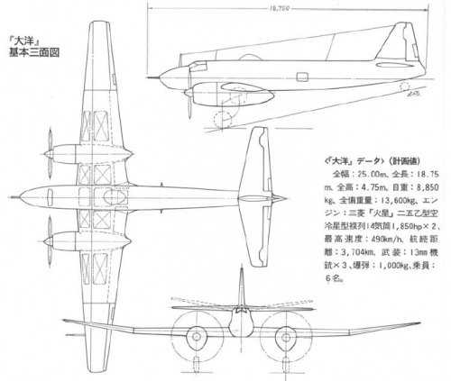

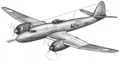

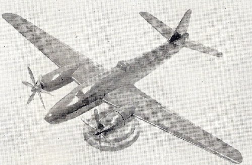

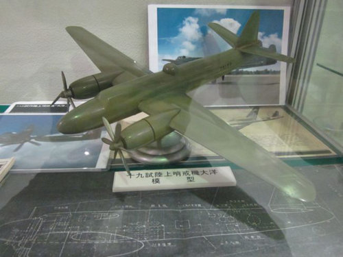

Hi! 17-shi Experimental Patrol Bomber "Taiyo,Q2M1". It had wooden structure. Kiro Honjo(本庄季郎,designer of G4M) designed this aircraft.
Wing span:25.0m, Length:18.75m, Height:4.75m, Wing Area:62.5m, Empty Weight:8,850kg, MTOW:13,600kg,
Wing Loading:217.6kg/m2, Engine:Mitsubishi Kasei(1,840hp in take off),
Max speed:491km/h, Range:3,700km
Source:JAPAN PROJECT AIRCRAFT, KOEI, Tokyo, 1997, ISBN4-87719-490-8 C0031

Hi blackkite nice pics of the taiyo! this plane looks much much better than the flimsy looking Kyushu Q1W Tokai.
The Japanese were very advanced in developing type aircraft to counter the submarine thread,the allies didn't develop special aircraft designed to do anti submarine missions,they used waterplanes or torpedo bombers to do the job like the Catalina,Sunderland or Grumman TBF Avenger.
This plane was a worthy forerunner of the LockheedMartin P-3 Orion and the new Japanese Kawasaki designed patrol aircraft.
I'm curious what sort of electronics this aircraft used to do his job,has it special radar to detect US submarines? has it MAD electronics?

MAD, almost certainly. The Q1W1 was designed to use MAD(part of why it had a wooden structure). I'd be very surprised if the Q2M1 wasn't supposed to carry MAD.

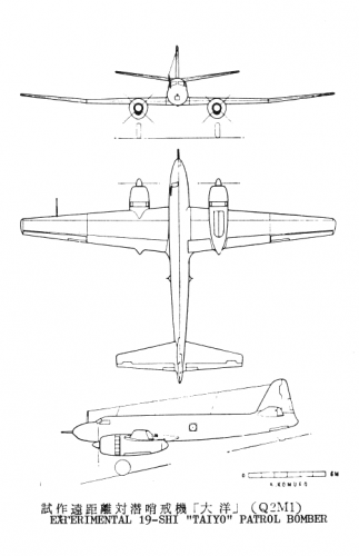

BTW, these drawings are the best I've seen of Q2M1. Any chance of there being a three-view drawing of it?

The "Q" designator for Navy patrol planes was used for only the Kyushu Q1W Tokai ("Lorna") and two more unbuilt projects.
  • the Mitsubishi Q2M Taiyo (Navy Experimental 19-Shi Patrol Plane)
  • the Kyushu Q3W Nankai (Navy Patrol Plane)
I'm attaching a three-view arrangement of the Q2M.
Unfortunately I have no picture of the Q3W project.

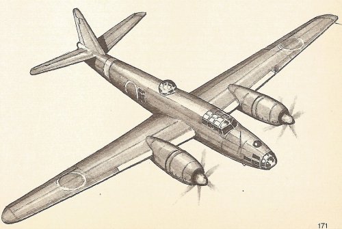

Mitsubishi Q2M, derived from the Mitsubishi Ki-67-I Hiryū "Peggy".

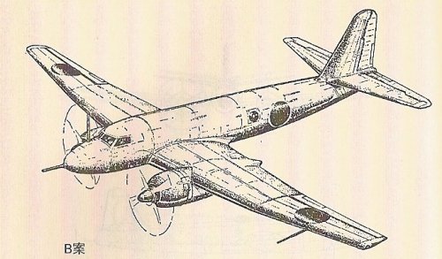

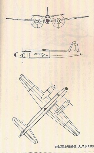

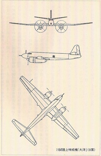

Hi! 17-shi Experimental Patrol Bomber "Taiyo,Q2M1" A plan. It had wooden structure. Kiro Honjo(本庄季郎,designer of G4M) designed this aircraft.Wing span:25.0m, Length:18.75m, Height:4.75m, Wing Area:62.5m, Empty Weight:8,850kg, MTOW:13,600kg, Wing Loading:217.6kg/m2, Engine:Mitsubishi Kasei(1,840hp in take off), Max speed:491km/h, Range:3,700kmSource:JAPAN PROJECT AIRCRAFT, KOEI, Tokyo, 1997, ISBN4-87719-490-8 C0031
Mitsubishi had 2 plans for Taiyo design, plan A and plan B.

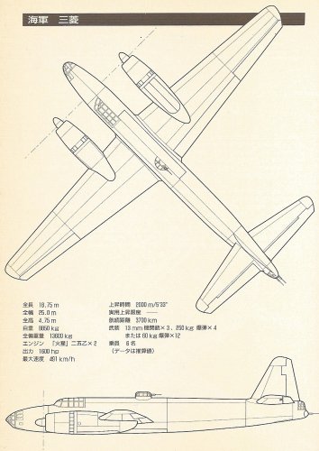

Hi Star! I will post some topics from recent Maru magazine. Little complicate tale. ;D
Please wait.
the Q2M 3-view;
The Xplanes of Imperial Japanese Army & Navy 1924-1945
