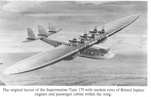

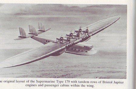

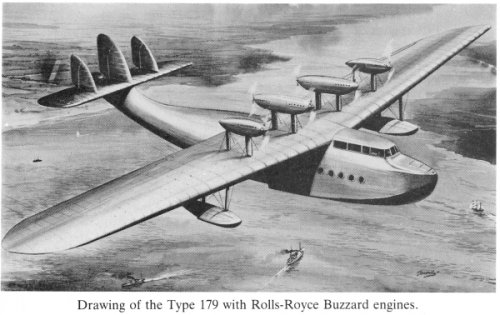

This would be the Supermarine Type 179 powered by 6 supercharged Rolls-Royce Buzzards giving 1030hp.
Correct.The original sheme for the Supermarine type 179 'Giant' used 6
Bristol Jupiter engines in tandem rows and had provision
for passenger cabins within the wings.
Supermarine Aircraft since 1914. CF Andrews & EB Morgan- Putnam.
An artist drawing to Model-179.
http://forum.keypublishing.com/showthread.php?t=86503&page=3
From putnam's 'Supermarine', pp315-9.
Before cancellation, the registration G-ABLE was allocated.

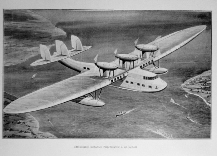

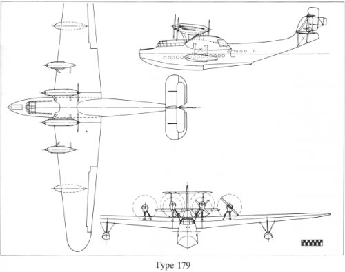

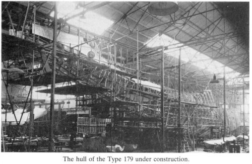

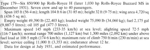

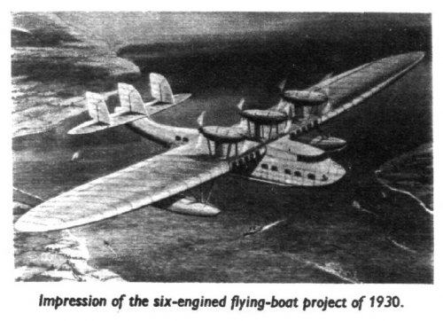

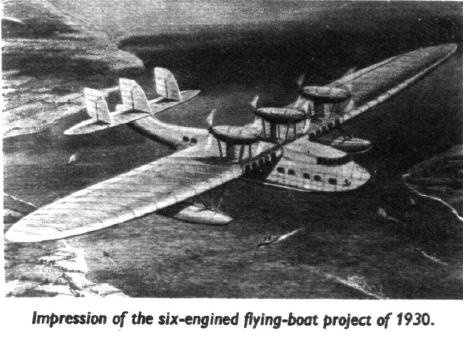

Great! Just found something myself: an alternate six-engined configuration (Source: Flight, 1953).

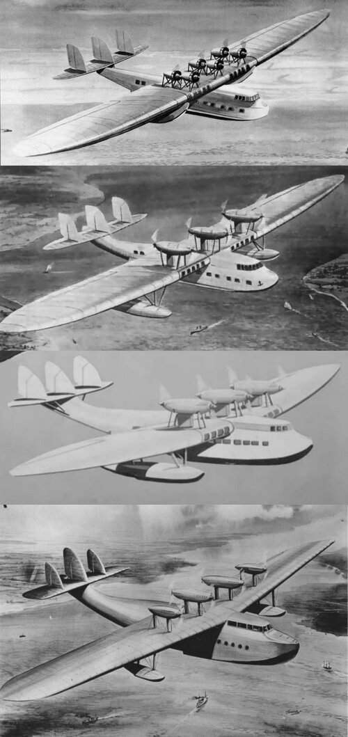

Please allow me to clarify the story regarding the Type 179.
Supermarine drew up a six-engine (probably RR Buzzard) monoplane, Type D in Supermarine's old project naming system, to spec. R.6/28 but this was not ordered by the Air Ministry.
The design was enlarged and modified as a civil flying boat, Type 179, powered by six Bristol Jupiters (see posts #5 and #6). One example was ordered by the Ministry to spec 20/28, but with the engines changed back to RR Buzzards (see posts #2 and #9).
The aircraft was then redesigned completely in 1930-1931; most noticeably the elliptical wing was dropped in favour of straight-tapered and eventually the three twin-engine nacelles became two twin-engine and two single engine (see posts #6 and #8)

Engines on top of the wings....is that a hangover from biplane seaplanes where they were between the wings?
Could they have been on the wing leading edge in an aircraft of this size?
It is a question of separation between the prop blades and the water, methink.
You want to maximize it, especially when the sea state is rough.

One other reason for not placing the engines on the leading edge was that this was utilised as a condenser for the evaporative cooling system. A further would be that three engines each side places the outer-engines a long way out.

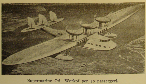

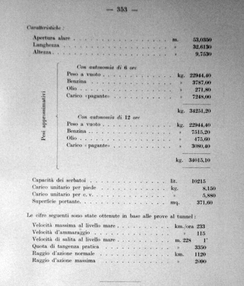

1931 Rivista Aeronautica

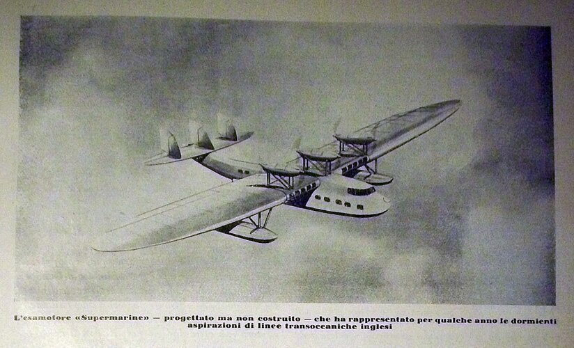

1933 Ala D'Italia
