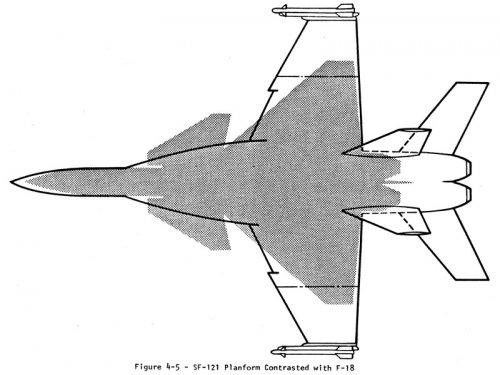

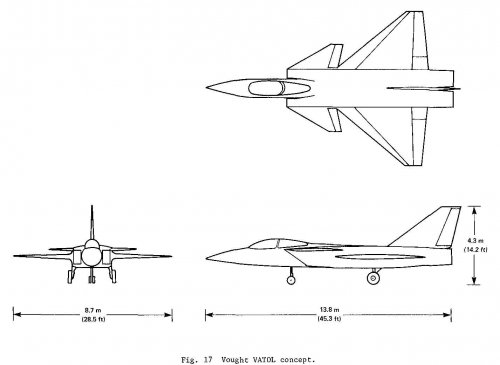

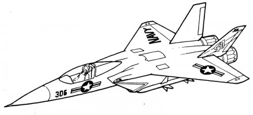

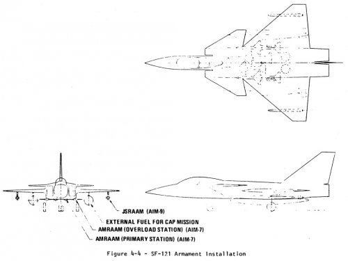

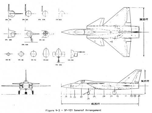

SF-106 was an ancestor of the SF-121.

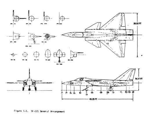

Vought NASA SF-121 contractor report:

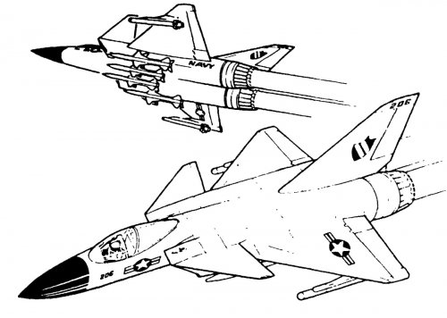

... and artwork for what appears to be the SF-106 design...
Enjoy the Day! Mark

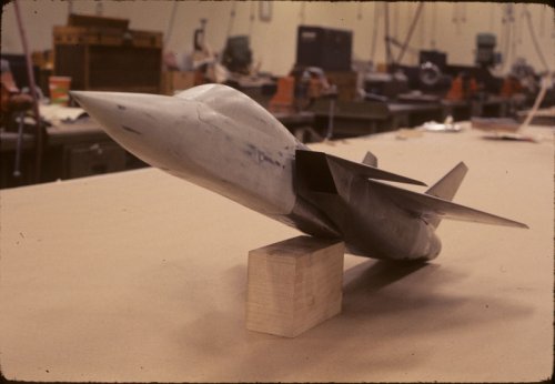

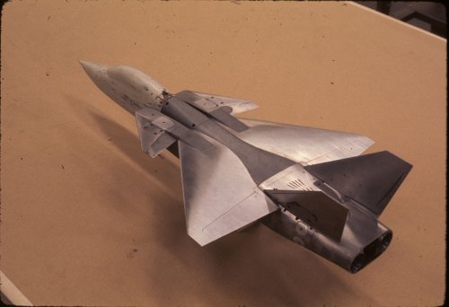

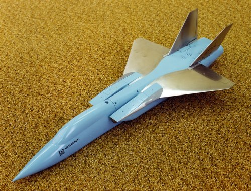

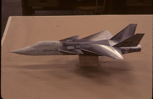

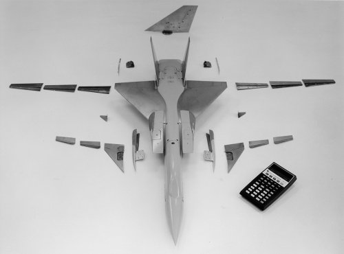

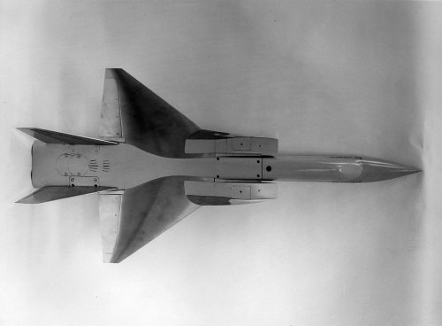

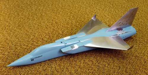

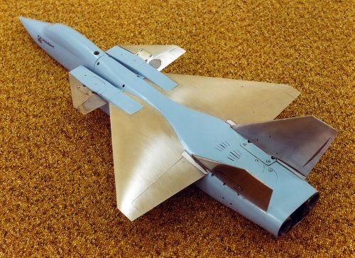

Here are a few more images of a wind tunnel model that appears to be for the SF-106 or thereabouts.
Enjoy the Day! Mark

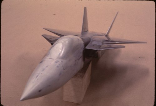

The wind tunnel picture shows several small triangular surfaces that can be tested next to the wing and canard. Were those winglets? One of the pictures of the assembled model seems to show them on the wing.
They look like interchangeable trailing edges for the wings and canards.
Not really your bad. The small nearly triangular pieces all by themselves behind the canard bits and forward of the wing and its bits are the winglets which are on the model in the third photo.
Enjoy the Day! Mark

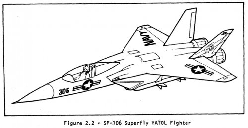

And of course, logically, the "SF-" in SF-106 also meant Superfly...
Figure 2-2 illustrates the original Vought approach to a Navy VATOL fighter, the SF-106 "Superfly". The configuratton is aggressively simple to minimize empty weight, cost and maintenance. The propulsion system is sized to permit a minimum weight vertical landing with either engine disabled. The landing gear i s compatible with vertical or horizontal attitude operations. The low aspect ratio delta wing was selected for low weight and supersonlc drag and for its gradual stalling characteristics. This configuration was tested in the Vought 4 x 4 foot Supersonic Wind Tunnel to Mach 2.4 and to 35 degrees angle of attack. The SF-121 configuration Incorporates lessons learned from these tests.

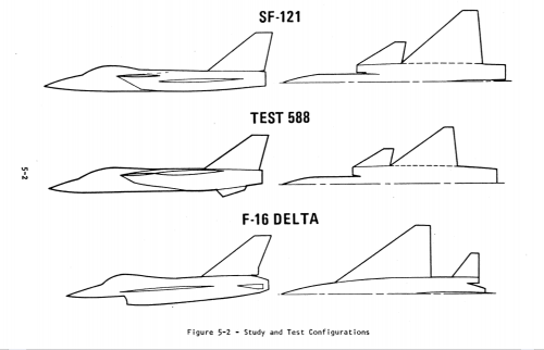

I believe Mark's wind tunnel photos are of the Vought High Speed Wind Tunnel modified SF-106 model - Test 588 conducted in September 1976. Reference to this model is given in the 1978 NASA contractor's report for the SF-121 (see pic below) proposal along with several curious references to the SF-122. The SF-122 is also referenced in later docs dated November 1980, but no details of the SF-122 can be found. Maybe a typo???

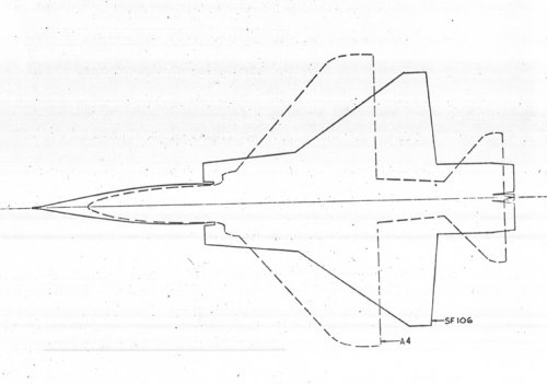

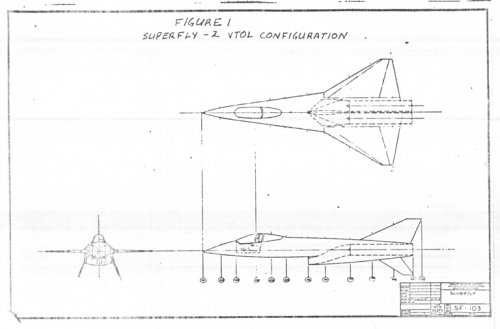

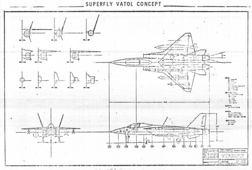

A few more to add to the Superfly conversation. First a disclaimer, these are poor quality. They appear to be 1970's photocopies of the presentation slides that I was able to scan. Sometimes you do the best with what you are presented. I hope they are still of interest. VAHF archives.
SF-103 General Arrangement
SF-105 General Arrangement
SF-106 and A-4 Plan View
I'm surprised you even ask the question... Thanks a lot for these great documents!

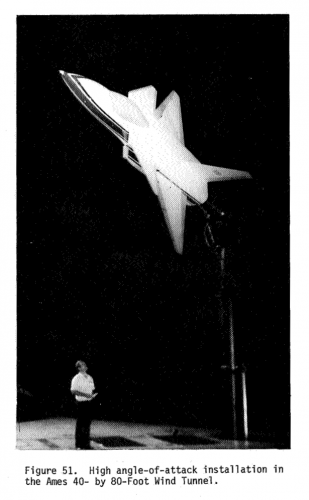

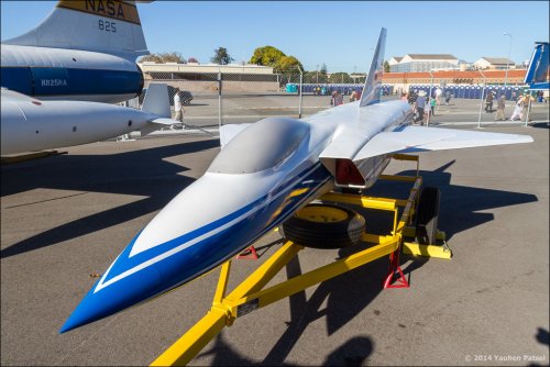

PaulMM (Overscan) said:
I'm going to guess this wind tunnel model shown at NASA Ames 75th Anniversary open day is a Vought SF-121. Its kind of generic canard delta though.
https://www.flickr.com/photos/gin_tonic/15640586696/in/set-72157649030746602
Great pic !!
I believe it is the very same 0.4 scale model used in the Ames 40 x 80 ft wind tunnel to evaluate the SF-121 configuration, specifically high AOA with sideslip tests on a rotating platform. The only pic I have seen is a VERY poor quality scan on page 35 of Assessment of Aerodynamic Performance of V/STOL and
STOVL Fighter Aircraft by W.P. Nelms - NASA Tech Memorandum 85937. Picture from the NASA memo is attached, I apologize for the bad quality, but dude provides good scale.. :)
link to NASA memo: http://hdl.handle.net/2060/19840014468
Documents indicate that Vought played around with the baseline SF-121 design quite a lot, in fact many of the illustrations in the 1978 contractors report to NASA of the SF-121 were actually the jet flap SF-120 (including the 3 view drawing).
