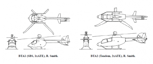

Just as a side note gents if I can, as I've already mentioned I've just finished reading Modern Battlefield Warplanes by David Donald. In it under the AH-64 Apache entry, it makes mention that:
"Hughes Helicopters responded to the AAH competition with a design based on it's egg-shaped OH-6......... However Hughes's designers respected its [the OH-6's] structural integrity enough to use it as their starting point.
All OH-6 developments soon turned out to be too small to make an effective AAH, so Hughes engineers ultimately produced the Model 77 [YAH-64]"
So does anyone have any pics / drawings of these OH-6 AAH derivatives????
I would be greatly interested!
