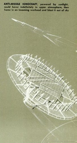

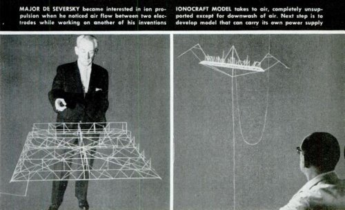

The engineers working on Ionocraft are the first to admit that their present rig is still a long way from any kind of practical aircraft. The model we saw measures only 1296 square inches and consists of about $5 worth of balsa wood and aluminum wire. But the principle holds an important promise for the future of aviation.
The problem now is improving efficiency --- getting enough lift from a given grid area and a given amount of energy, Present models cannot yet lift their own electric generators. they get power through a feeder cable, dangling down like an umbilical cord. Ionocraft engineers tend to be close-mouthed on performance figures.
But they will tell you that at present it takes 90 watts (30,000 volts at 3 milliamperes) to fly a two ounce model. Translated into ordinary power-to-weight ratios, this works out to roughly 0.96 hp. per pound, as compared with a typical 0.1 hp per pound of helicopter or 0.065 hp for a pound Piper Cub.
But Ionocraft designers are hard at work upping efficiency. One possible power --- boosting technique is to pulse the power in short high energy bursts rather than apply steady voltage. They are also trying out various grid patterns and ion emitter layouts to minimize energy loss through turbulence in the downdraft.

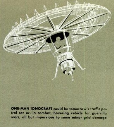

Despite such unresolved problems, the development crew almost bristles with optimism, and the most optimistic of all is the Ionocraft's inventor Major Alexander P. de Seversky. No crackpot, Major de Seversky is a practical visionary who in many areas has been far in front of his field.
"We hope to fly a model with self-contained power, perhaps by the end of the year (...) Ultimately, the ionic drive will prove more efficient than either propeller or jet as a method of aircraft propulsion."
