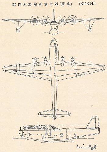

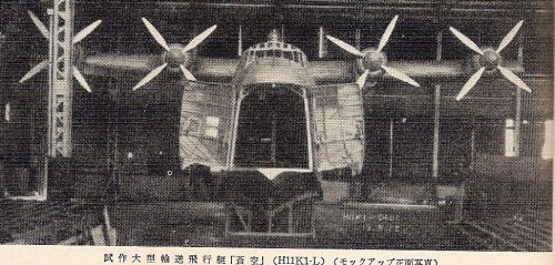

Hi! 1/2 scale Soku mock up and 3-side view. Enjoy.
Wing Span:48.0m, Length:37.73m, Height:12.578m, Wing Area:290.0m, MTOW:45,500kg, Wing Loading:156.8kg/m2, Engine:Mitsubishi Kasei(火星,Mars) air coolind radial 14 cylinder(1,850hp in take off)
Source:My No.2 Bible.

Nice drawing and photo of the Soku you have send Blackkite,It most become enormous!
The Japanese could have used after a little conversion work,this aircraft as a cheap alternative for the Fugaku.
All I now about this big Sea plane is the project died when the muck up was lost in a air raid.

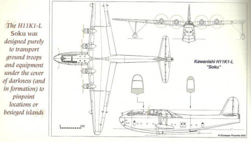

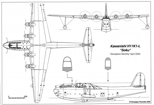

I have this general arrangement,from "Aeroplane Monthly", so I imagine many of you will know of it.
