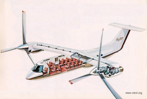

Artist's impression of Bell D-326 Clipper tiltrotor.

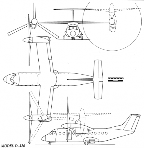

A three-view arrangement:
