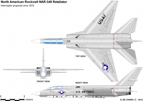

First of all, let me thanks all of you sirs for your kind comments about my work.
To realize the NAR-339 drawing I started, obviously, from the original A-5 drawings (there's a lot available on the net and in several dedicated publications as Squadron/Signal and Aerofax ones, for istance) helped with very few drawings found out on Internet (at least only three!! I know, is very poor references but anyway better than nothing).
I enclose the drawings I have about the matter, even I'm pretty sure that they can also be found on this Forum in appropriate topic.
I agree that a twin tail A-5 would be more effective (and even have more appeal, a sort of Tomcat's prequel) but I've found anything about that and I don't like to speculate without solid ground proofs.

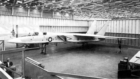

"The original NAGPAW design had twin vertical stabilizers, and this was actually how the mock-up was configured when it was reviewed in March of 1956. However this was changed to a single vertical stabilizer shortly thereafter (the USN getting cold feet with this revolutionary design idea of smaller twin-vertical stabilizers). The vertical tail was sufficiently tall that it had to be fitted with a hinge so that the top could be folded to the left for stowage aboard aircraft carriers."
Regards
Pioneer
  • The mock-up of the North American NAGPAW (North American General Purpose Attack Weapon) in 1957.jpg
Pioneer said:
"The original NAGPAW design had twin vertical stabilizers, ...."
We had the NAGPAW here http://www.secretprojects.co.uk/forum/index.php/topic,659.15.html ,
the patent only shows a single fin, but maybe that the actual design actually started with twin fins,
when the patent already was filed. But re-reading the post in the mentioned thread, there still seem
to be some uncertainty.

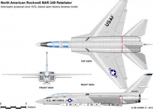

Thanks to our Circle-5, which provided me several neat shots of factory desktop model of NR-349, I was able to modify (or at least improve) my drawing, any comment is welcomed (as always).
I don't know enough to 'critique' it, but I do know that I love your talent & style of work. Thanks.
Thanks Foiling, your appreciation and kind words are always welcomed.
