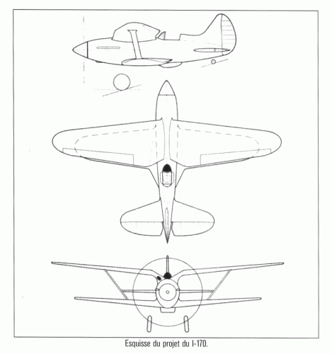

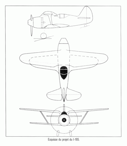

I have looked unsuccessfully on this forum for information on the little-known Polikarpov I-170 and I-195 projects, which represented (along with the built I-190 prototype) the last heirs of the I-15 line of biplanes.
Allow me to share here some three-view arrangements taken from the French Air Magazine N°8.

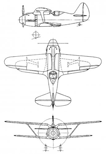

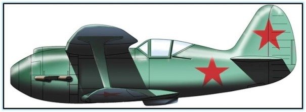

A bit more for I-195 the last biplane:

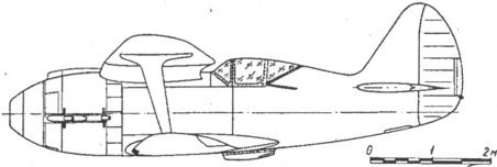

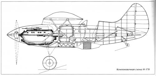

The I-170 layout (From: Maslov M. The I-153. - Moscow, Aviantik, 2001 (ISBN 5-93848-003-5). - Page 82).

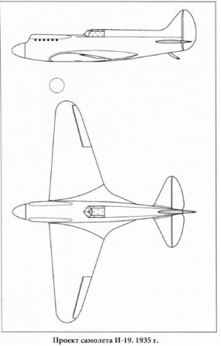

here is a Polikarpov I-19 drawing,a low-wing single seat monoplane fighter
project of 1935.

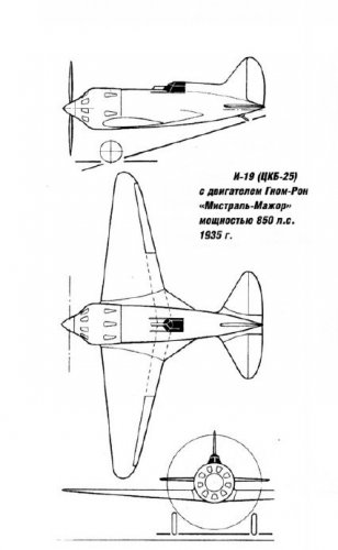

Polikarpov I-19 (TsKB-25). There were two totally different projects under this designation. The first one was I-16 derivative for Gnome-Rhone Mistral Major (M-85) engine. It was projected in mid-1935 but soon cancelled, and the designation was re-used for I-17 version with Mikulin M-34 FRN engine. The 2 vievs of posted by Hesham.
Initially TsKB-25 was the designation I-19, then later, in the same 1935 it renamed I-20.
And indeed, "All curiouser and curiouser" ... what do monoplane fighter in the topic / thread:
"Polikarpov's last biplanes: the I-170 and I-195 projects" ))?

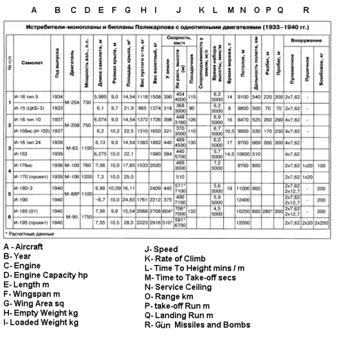

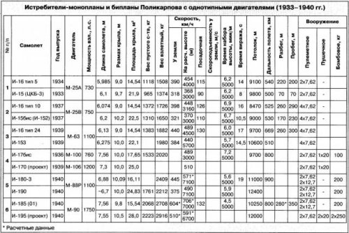

From the Ukrainian magazine Aviatsia Vreyma 2005, issue 6.
Some more details on the Polikarpov I-170 and I-195 aircraft, compared with other contemporary Polikarpov designs.
