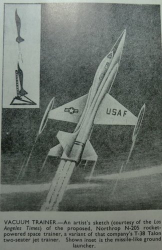

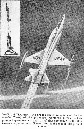

Been meaning to post that for ages and Im sure I've seen it elsewhere.
Regards,
Barry
Jens, your file has a typo, it should read "N-205", not "N-250".
The Space Trainer was no April fool. I have in my list as the N-205B, a planned T-38 derivative with a maximum altitude of 50 miles and a top speed in excess of Mach 3. However, I wonder if the "B" suffix implies there were several different configurations studied.
Jemiba said:
Sorry for the typo.
In fact it was your list, that made me feel confident, that it was really a Northrop project. ;)
