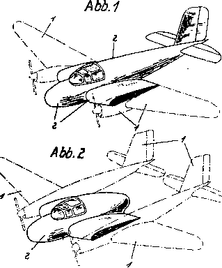

a clever patent idea from Henschel for a detachable engines and wings in upper drawing,and a
detachable engines,wings and booms in lower drawing.

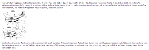

It's a description of fitting multi-engined aircraft with a floatable cabin/fuselage and
means of detaching wings with the engines and maybe the tail. In the event of a ditching,
those parts would be jettisoned and the remaining parts of the wing would act as stabilizing
floats.

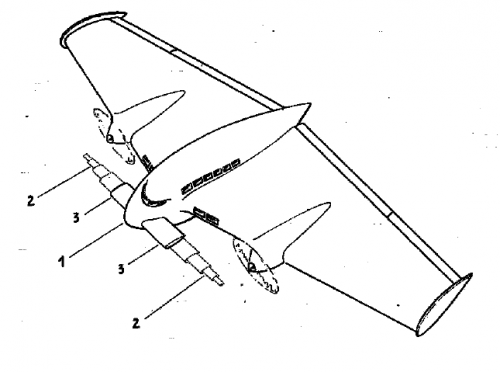

The patent shows an aircraft with adjustable canards.
https://patents.google.com/patent/DE748739C
