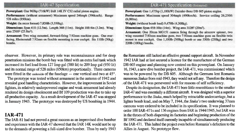

IAR-42 - (Project?) 1942 2-seat, low-wing (military?) monoplane
- IAR-42 : 1 x 1,050 hp IAR 1000-A 14-cyl radial, span (??) m
-- IAR-42 design poss. related to IAR-47 (qv) development (??)

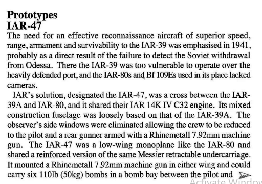

IAR-47 - 1942 low-winged monoplane 2-seat recce-bomber, x 1*
- IAR-47: IAR-39 repl., IAR-39 fuselage + wing sim. to IAR-80
- IAR-47: 1 x 960 hp IAR 14K IV C32 radial, span 12.50 m
-- 3 x 7.92mm Rheinmetall mg (2 fixed, 1 flex), 6 x 50 kg bombs
-- * Const. of 3 prototypes begun 1940, cancelled Jan 1943
-- * 1 finished and flight-tested, destroyed 1944 by US bombing
-- https://www.secretprojects.co.uk/threads/iar-47.10559/

IAR-471 - (Project) 1944 low-wing monoplane 2-seat divebomber
- IAR-471: Planned repl. for FARR Junkers Ju-87D Stukas
- IAR-471: 1 x 1,475 hp Daimler Benz DB 605A, span 14.00 m
- IAR-471: Retr. main u/c, largely unrelated to earlier IAR-47
-- 1 x 20 mm MG151/20 + 4 x 7.92mm mgs (2 fixed, 1 flexible)
-- 1 x 500 kg bomb, or 1 x 250 kg bomb + 2 x 100 kg bombs
-- 1944, 100 x IAR-471 ordered for FARR 1944, IAR couldn't deliver

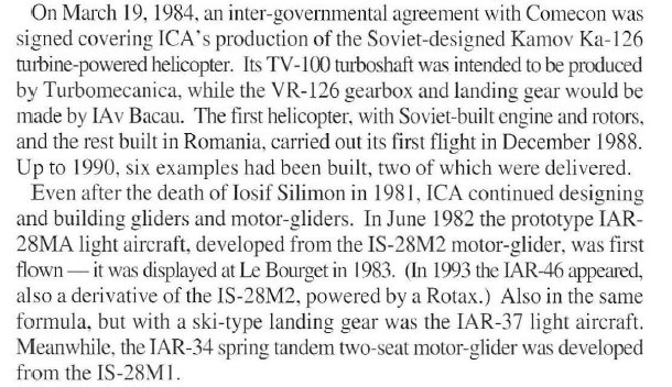

IAR-28MA - 1982 motor-glider deriv. from IS-28M2
- IAR-28MA: 1 x 80hp Limbach L.2000 E01 HO4, span (??) m
- IAR-28MA: Non-sequential desig. obviously deriv. from IS-28M series
IAR-34 - 199(?) Redesignation of IS-28M1 Motor Lark
IAR-35 - Acro, 1990 metal single-seat glider, low-tail, span 12.00 m
IAR-37 - 199(?) light a/c with ski undercarriage
IAR-46 - 1993 lightplane prototype based on IS-28M2
- IAR-46 : 1 x 80hp Rotax 912 F3/A3 HO4, span (??)m

Kamov Ka-126 - no obvious Romanian desig. for locally-assembled 'Hoodlum-B'
-- Ka-126: first Rom example flown 1988, 1 x 720shp OMKB Mars TVD-100 turboshaft

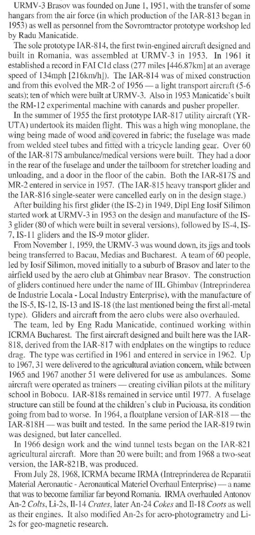

IAR-811 - 1949 2-seat cabin monoplane, design begun 1944
- IAR-811: First post-WW2 Romanian-produced aircraft
- IAR-811: 1 x 60 hp Train 6T 6-cylinder inline, span 10.00 m
IAR-812 - (Project) 194(?) trainer, cancelled at early stage
- IAR-812: No sufficiently powerful engine then available

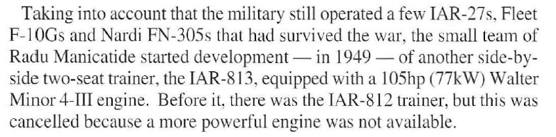

IAR-813 - 1950 2-seat side-by-side trainer/sports a/c, x 80
- IAR-813: IAR-811 evolution, higher powered, bubble canopy
- IAR-813: 1 x 105 hp Walter Minor 4-III, span 10.00 m
- IAR-813: Radu Manicatide design to replace existing a/c*
-- * IAR-27, Fleet Model 10G, and Nardi FN 305 trainers
IAR-814 - 1953 3-seat monoplane multi-purpose transport, x 10*
- IAR-814: For light transport, pilot trainer, or ambulance
- IAR-814: 2 x 160 hp Walter Minor 6-III, span 14.00 m
-- Design begun 1951, 2 x prototypes + production MR-2 model
- MR-2 : Production version, for 'Manicatide, Radu 2', x 8
-- * Some sources say 2 x prototypes, 10 x production MR-2s
IAR-815 - (Project) 1951 heavy transport glider, prototype ordered*
- IAR-815: Prototype order cancelled at an early stage
-- * Romaero 1951-2008, Constantin Dinischiotu, Vremea, 2019
IAR-816 - (Project) 1951(?) single-seater, no details
- IAR-816: Project cancelled at an early stage
IAR-817 - 1955 high-wing monoplane light multi-purpose a/c, x 30*
- IAR-817 : Tricycle u/c with rear-loading pod-and-boom fuselage
- IAR-817 : 1 x 160 hp Walter Minor 6-III, span 12.60 m
- IAR-817 : Mixed constr., fabric-covered wood wing/steel-tube fuselage
-- Intended as ag a/c, to parachute training, mailplane, ambulance
- IAR-817S: (Sanitar) 1957 medevac, 1 x stretcher, 1 x seated
-- * Some sources list 60+ (??)
IAR-818 - 1960 high-wing monoplane light multi-purpose a/c, x 82*
- IAR-818 : IAR-817 dev., higher power engine, wing endplates
- IAR-818 : 1 x 170 hp Walter M-337 6-cylinder, span 12.80 m
- IAR-818H: (Hidro), 1964 twin-float variant of IAR-817**
-- * Others say as high as x 104 (Poss. x 105 with c/n 18 duplicated)
-- ** c/n 28 YR-AVN, later on wheels with Aviasan (medevac)
-- https://www.airliners.net/photo/Aviasan/IAR-IAR-818H/1819661

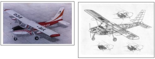

Thanks Hesham, I've added the IAR-815 as a transport project.
IAR-T UAV was listed under 'Aberrant Non-Sequential IAR Designations'. I've added the IAR-2000 to the same section. http://www.secretprojects.co.uk/forum/index.php/topic,13412.msg133105.html#msg133105
IAR-92 still seems slippery to me but I've made the listing firmer in any case.
Thus far, ECO 100 remains an in-house project by INCAS' Aircraft Design Group. I suppose, if this light plane is productionized, we'll see an IAR designation applied later for marketing purposes.

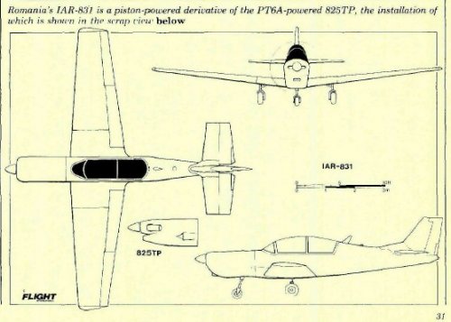

IAR-831 - Pelican, 1985 piston-engined version of IAR-825TP, 1 built (YR-IGA)
- IAR-831: aka ICA IAR-831, 1 x 290hp Lycoming IO-540 G1D5 flat-six
-- combines IAR-823 powerplant with IAR-825TP Triumf tandem-seat airframe
_____________________________

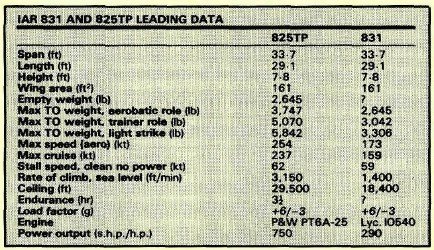

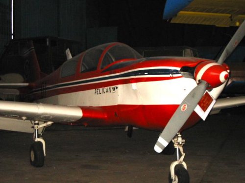

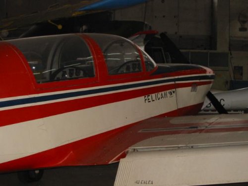

More on the IAR 831:
The prototype was produced in 1983 and presented at the Paris Air Show the same year, registered YR-IGA.
This aircraft still exist, stored at IAR Brasov (photos taken in 2002)
Sources:
http://www.flightglobal.com/pdfarchive/view/1983/1983%20-%201203.html?search=IAR%20831
http://www.flightglobal.com/pdfarchive/view/1983/1983%20-%201060.html?search=IAR%20831

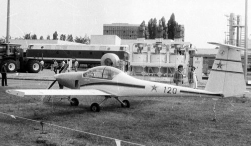

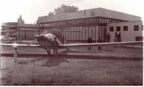

Dear Apophenia,
I read with great interest your extensive article. This prompted me to following questions.
Can you identify the tricycle gear/T-tail aircraft (see photo). Has it anything to do with the IAR-34 or IAR-39?
You mention that IAR-34 is new designation for the IS-28M2. Please see attached photo of IAR-34 and this has a central main wheel. The IS-28M2 in my opinion has a conventional gear. Can it be that IAR-34 was IS-28M1 and not M2?
Regards, Walter

walter: Ack! You're quite right. The IAR-34 was the IS-28M1 and not IS-28M2!
Sorry, I can't help with identifying your T-tailed light plane.

IAR-815 was not a transport aircraft,but a glider,maybe remained a Project;
http://www.roaf.ro/ro/cer_senin/arhiva/2002/Nr.6.pdf

Late 80s Romania had a lot of plans for upgrading their older equipment. I remember reading on a Romanian-language forum that they planned on putting laser range finders on their T-34s!
From AE # 56.
From AE 74,
here is a small info about IAR-815,IAR-816 & IAR-819.
Thanks hesham. I've revised the IAR-8xx series entries. I've also added the 'duplicate' designation IAR-101 and IAR-109 which have mentioned elsewhere.

IAR-42 was a two-seat low-wing monoplane of 1942,powered by one IAR-1000 A engine,but there is no details for its function,strong feeling it was a military aircraft,
but maybe remained a project only ?!.
